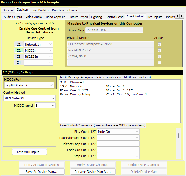

If you want to control SCS cues by MIDI messages sent by an external device then enter the relevant detail as a Cue Control Device. The layout of the lower part of the screen depends on the Device Type of the currently-selected device, and for MIDI devices the layout is further dependent on the Control Method. The example below shows the layout for a MIDI device with a Control Method of 'MIDI Note On'.

Device Number (C1, C2, etc): If this number is displayed with a colored background (eg see C1 in the above screenshot) this indicates this device is the 'current' device for the 'Settings' panel displayed below the device list. To make a different device the 'current' device, click on any field in the line for the required device, or on the Device Number itself.
Device Type: This drop-down list contains the Cue Control device types supported by your license level.
Computer-Specific Fields
Physical Device: The physical device assigned to this Cue Control Device. The Physical Device is a display-only field based on the 'Settings' provided in the lower part of the screen.
Active?: This display-only checkbox will be checked if SCS has successfully initialized this device, or will be blank if the initialization failed. If you have devices that have not been initialized successfully, click Retry Activating Devices at the bottom of this tab.
MIDI In Port: Select the required MIDI In Port from the drop-down list. The entries available in the list will depend on the installed devices and possibly whether or not they are connected and switched on.
Other MIDI In Settings
Control Method: This drop-down list contains some preset control methods available for cue control, as well as a 'custom' method where you can set up your own MIDI assignments. For methods other than MSC (MIDI Show Control) and MMC (MIDI Machine Control) you will see a scrollable panel display entitled Cue Control Commands. This panel is described later. The following Control Methods are available:

When you select a Control Method and select any necessary additional information, the display panel on the right (MIDI Message Assignments) will provide you with a summary of the message types that SCS will respond to, provided corresponding cues are included in your cue file.

If the Control Method is other than MSC and MMC then the Cue Control Commands panel will be displayed. Note that each of the messages listed in this panel has a MIDI channel component, so SCS will only respond to such messages if the MIDI channel matches the MIDI Channel nominated in these Options.
This panel is scrollable, so use the scroll bar on the right to see additional Cue Control commands. The first few commands are cue-related commands, eg 'Play Cue 1-127'. The numbers 1-127 refer to MIDI Cue Numbers, which you can assign to cues that need them (ie cues you want to control via MIDI). See Cue Properties for information on setting a cue's MIDI Cue Number. You would normally want to set a cue's MIDI Cue Number to match the Cue Label, eg for Q7 you would assign MIDI Cue Number 7. However, as the non-MSC formats only have 7 bits for a cue number, only MIDI cue numbers up to 127 can be recognized. (The ETC methods get around this restriction for 'Play Cue', allowing for MIDI cue numbers up to 999, but the limit of 127 still applies to the other command types, such as 'Stop Cue'.)
This panel provides information on how the selected MIDI message types are mapped to SCS cues.
