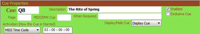

For example:
Note that the MTC Time is actually 4 fields and you can tab between them as required. The default time is 00:00:00:00, so if you just need to set the 'hours' component then the first of these fields is the only one you need to change
