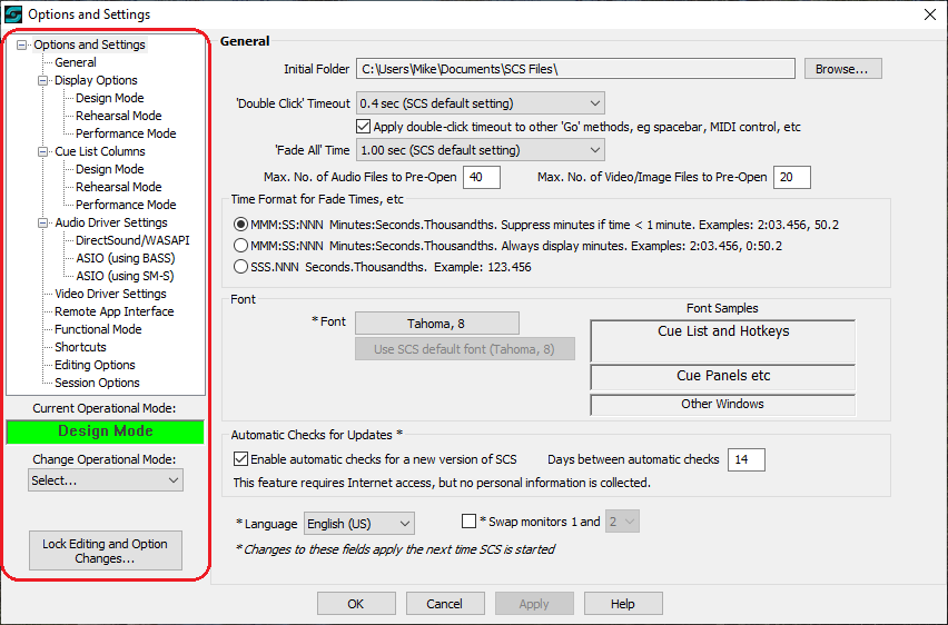

The Options and Settings window appears like this (but without the red outline):
Options and Settings: This 'tree view' lists the groups of options available. Some of these options may not be displayed if your SCS license doesn't permit the use of the relevant facilities. To access the particular options, just click on the required node.

Current Operational Mode: This displays the currently-selected Operational Mode.
Change Operational Mode: Use this drop-down list to change the Operational Mode. As with all Options and Settings, the selected Operational Mode will be saved when you click Apply or OK and so will be 'remembered' across SCS sessions.
Lock Editing and Option Changes: This button opens a dialog window that enables you to lock the Editor and Options and Settings. The facility is password-controlled, using a 'Sound Designer Password'. If you have not yet specified a 'Sound Designer Password', or if you have forgotten the password, then you can click on a link to open a window to enter a new password. That window requires you to enter your SCS Authorization String to confirm the authenticity of the request.
