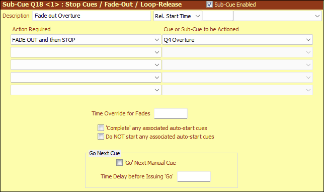

For an SFR cue or sub-cue, a sub-cue panel like this will be displayed:
Note that SFR cues cannot be used to fade lighting cues. SFR cues are designed for audio and video cues.
Sub-Cue Description: Enter a description for this sub-cue. You can leave this field blank and let SCS create a default Description for you from the first line under Cue to be Actioned and Action Required.
Action Required and Cue or Sub-Cue to be Actioned
