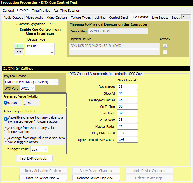

If you want to control SCS cues by DMX messages received from an external device, then enter the relevant detail as a Cue Control Device. The layout of the lower part of the screen depends on the Device Type of the currently-selected device. The example below shows the layout for a DMX In device.
Enable Cue Control from these Interfaces
SCS allows you to nominate up to four devices from which SCS can be remotely controlled, such as from a lighting board. However, it would not be common to have remote control from more than one device so you will probably only have a 'C1' entry.
All your Device mappings are held in a Device Map. This is the same Device Map used for Audio Output Devices, so the name of that Device Map is displayed but is not editable here.
The Physical Devices chosen are for this Device Map on this computer.
Device Number (C1, C2, etc): If this number is displayed with a colored background (eg see C1 in the above screenshot) this indicates this device is the 'current' device for the 'Settings' panel displayed below the device list. To make a different device the 'current' device, click on any field in the line for the required device, or on the Device Number itself.
Device Type: This drop-down list contains the Cue Control device types supported by your license level.
Computer-Specific Fields
Physical Device: The physical device assigned to this Cue Control Device. The Physical Device is a display-only field based on the 'Settings' provided in the lower part of the screen.
Active?: This display-only checkbox will be checked if SCS has successfully initialized this device, or will be blank if the initialization failed. If you have devices that have not been initialized successfully, click Retry Activating Devices at the bottom of this tab.
DMX Port: Select the DMX Receive device (or port) that corresponds to the physical device or port connected by DMX cable to the relevant Show Control device (eg lighting board).
Other DMX In Settings
Preferred Value Notation: If your Show Control device (eg lighting board) has fader levels marked as a percentage then you may wish to select '%' as the Preferred Value Notation. The default setting is '0-255' which is the actual value range of DMX channel values. Note that the Preferred Value Notation only affects how values are displayed. Internally, SCS uses 0-255 values.
Action Trigger Control: This determines the value change required to trigger an action, such as the 'Go' Button action. The options are:
A positive change from any value to a nominated value triggers the action, where the 'nominated value' is specified in the Trigger Value field. The default value is 255 (the maximum value), which means that if the value changes from any value in the range 0-254 to value 255, then action is triggered. If you choose a value less than 255 then note that the action will only be triggered on a positive change. For example, if you choose the value 200 then the action will trigger if the DMX channel value changes from 199 to 200, but will not trigger if the DMX channel value changes from 201 to 200 as that is a negative change. Also, the action will not trigger if the DMX channel value changes from 199 directly to 201 as the 'nominated value' of 200 is not received. The default value of 255 is therefore the most useful unless you have some particular reason for using a lower value.
A change from zero to any value triggers the action. So a change of value from 0 to any value in the range 1-255 will trigger the action, but a change from any value in the range 1-255 to any other value (including 0) will not trigger the action.
A change from any value to a non-zero value triggers the action. This was how SCS checked for trigger control in versions prior to SCS 11.2.6 and is retained for backward-compatibility. However, this can cause unwanted repeats of actions, especially if DMX control is sent from a fader. It is recommended you use one of the other action trigger control options, depending on your specific needs and equipment setup.
Note that Action Trigger Control does not apply to Master Fader as this uses the value to determine the level.
DMX Channel Assignments for controlling SCS Cues
In this panel you nominate which SCS commands may be controlled by DMX messages.
DMX Channel: Against each listed SCS command, enter the DMX Channel (1-512) assigned to control that command, or leave the field blank if the command is NOT to be controlled by DMX.
These are the commands currently supported, and how they are DMX controlled:

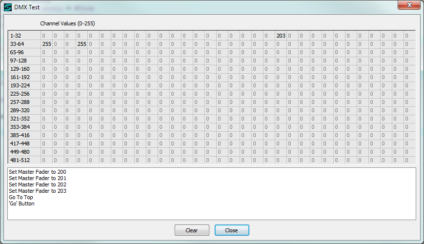

Test DMX Control
Having selected a DMX In device and relevant details, you can now check that SCS is receiving and recognizing these messages by clicking the Test DMX Control button. This will open a DMX Test window, and selected incoming DMX messages will be displayed in that window. Where the message is recognizable for control purposes, the SCS command is displayed.
The Test DMX window looks like this:
In the above example, the only channels with a non-zero values are 21, 33 and 36. Channel 21 has been assigned to the Master Fader. During the course of this test, the fader on the controlling device was set to 200 and then moved to 203. The values in channels 33 and 36 both hit 255 so triggered the assigned actions.
You can clear messages from the window by clicking the Clear button. This does not clear the DMX channel matrix. Close the window by clicking the Close button.
