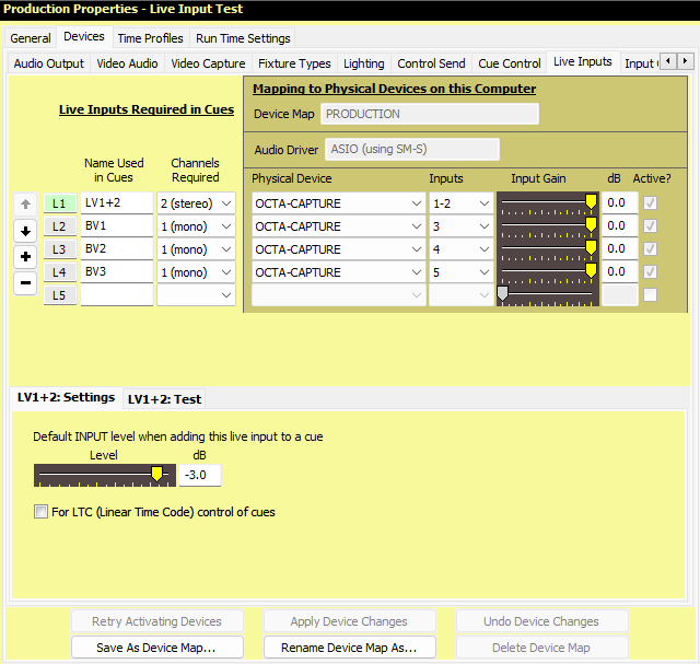

Here's an example of the Production Properties for some Live Inputs:

Here you need to identify each input you want to use in Live Input cues. You give each input a Name that will be used in your Live Input cues.
All your Device mappings are held in a Device Map. This is the same Device Map used for Audio Output Devices, so the name of that Device Map is displayed but is not editable here.
The Physical Devices chosen are for this Device Map on this computer.
Device Number (L1, L2, etc): If this number is displayed with a colored background (eg see L1 in the above screenshot) this indicates this device is the 'current' device for the Sidebar Controls to the left, and for the 'Settings' panel displayed below the device list. To make a different device the 'current' device, click on any field in the line for the required device, or on the Device Number itself.
Sidebar Controls: Controls are available to enable you to easily change the order of the devices as explained for Audio Output Devices.
Name Used in Cues: Enter the name you want to use for the input in your Live Input cues.
Channels Required: Live Inputs in SCS may be mono or stereo. Select as required.
Computer-Specific / Device Map-Specific Fields
Device Map: This is a display-only field showing the Device Map currently selected for this production in the Audio Output Devices tab.
Audio Driver: This is a display-only field showing the Audio Driver currently selected for this production in the Audio Output Devices tab.
Physical Device: The ASIO device assigned to this Name Used in Cues.
Inputs: This drop-down list contains the available ASIO input channels on the selected ASIO device. Select the required input channels for this Live Input.
Input Gain and dB: This is like a trim control for this physical input in this Device Map. It is therefore a Master Input Gain control for the input channel.
Active?: This display-only checkbox will be checked if SCS has successfully initialized this device, or will be blank if the initialization failed. If you have devices that have not been initialized successfully, click Retry Activating Devices at the bottom of this tab.
Default Settings
Default INPUT level when adding this live input to a cue: This gives the level to be used when adding this Live Input to a cue. You can, of course, subsequently change the level in the cue itself.
Important: There is a difference between Input Gain and Input level. This is best explained by likening the controls to those of a sound mixer, such as those of the Mackie 3204-VLZ3 shown opposite.
The SCS Input Gain control is a Master Input Gain control that sets the maximum actual input level.
The SCS Input Level controls on individual cues, with a default set according to Default INPUT Level control, allow individual cues to use different input levels within the range specified by the Input Gain control.
The Input Gain and Input Level controls are additive, so if you have an Input Gain of -3.1dB and an Input Level of -3.0dB then that input will be attenuated -6.1dB.
