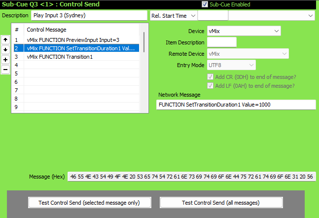

Here is an example of a Control Send Cue that sends three messages to vMix:
This example is taken from a scenario where the user had pre-loaded into vMix every video required for the production, in specific input slots, as well as a black color input in the first input slot.
When the above cue is played, SCS would send these three commands consecutively to vMix:
1."FUNCTION PreviewInput Input=2" which will load input 2 (a video file) into the vMix Preview Window.
2."FUNCTION SetTransitionDuration1 Value=1000" which will set the duration of 'transition 1' to 1 second.
3."FUNCTION Transition1" which will transition the content of the Preview Window to the Output Window.
The effect of this cue is that the video file in Input 2 will start playing in the vMix Output Window (eg via a video projector), fading in the video over 1 second.
