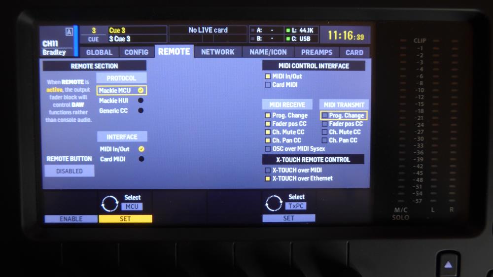

That was my error as I had not set up the board correctly, so as a reminder to everyone this is what I needed to configure
On the X32, Settings >> Remote
Protocol = Generic CC
Interface = Card MIDI
MIDI Control Interface = CARD MIDI
Remote Button Disabled
MIDI Recieve
Prog. Change = selected
Fader pos CC = selected
Ch. Mute CC = selected
CH. Pan CC = selected
MIDI Transmit
The MIDI Transmit I have set because one of the assignable buttons has been programmed to send a GO message to SCS Cue Control

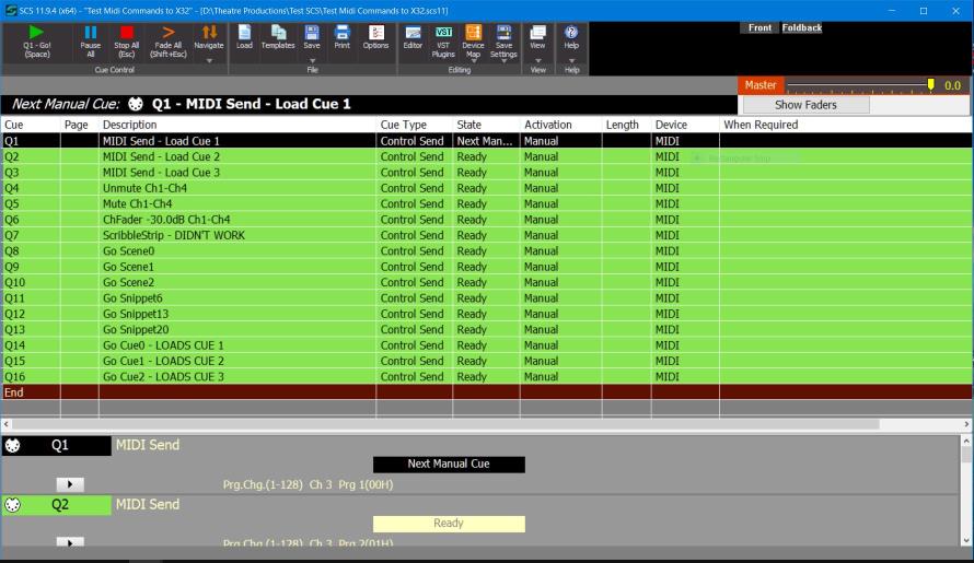

Post by BJB » Fri Aug 19, 2022 1:43 pm
Further to the posts above, I have tested sending various MIDI commands from SCS to an X32 Compact mixer and, with one exception, everything worked. Below are screenshots of my X32 setup and SCS Cuelist.
As anticipated, there is an offset of 1 when using the Load Cue command. Cue numbering on Scenes and Snippets starts at 0, but starts at 1 for Cues!
The only thing which I couldn't get to work was the ScribbleStrip command for naming the Scribble strips - not a big issue as X32TC generally looks after all that, particularly for the bigger theatre shows.

Post by Mike Daniell » Fri Aug 19, 2022 4:06 pm
Many thanks, Tim and Brendan, for this further testing of the X32 MIDI control.
I hadn't included scribble strip retrieval or updating as the required MIDI commands are not documented. However, on further investigation it does appear that sending OSC over MIDI using Sysex commands my provide the functionality I need. I'll look into this later.
