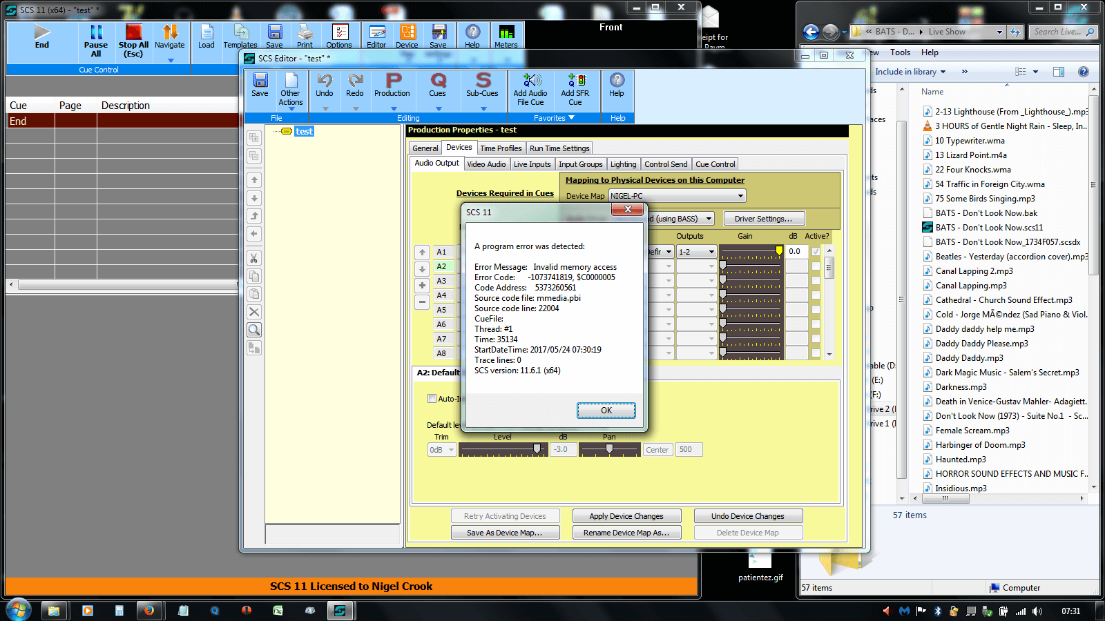

I have just tried creating the offending cues in a new file and I get a program error when selecting the audio devices:
I have also attached a diagnostic file.

Nigel,
I've emailed you details of a version that should fix the memory error and hopefully will also fix the 'jumpy fades'. The memory error is the same as that reported in the bug report crashing when select midi.
