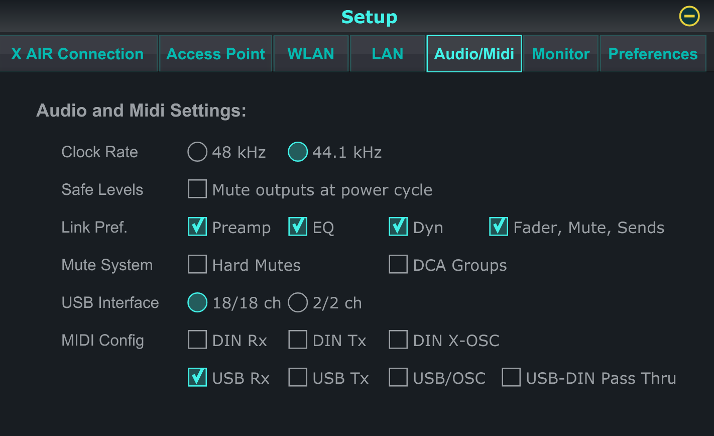

sjwicks
Posts: 52
Joined: Wed Sep 16, 2009 10:08 pm
Location: Bromsgrove, UK
Re: ShowCueSystem and Behringer X32 Demo
Post by sjwicks » Tue Oct 25, 2016 1:26 am
Just finished the run of Legally Blonde at a local theatre and can report the faultless integration of SCS and the X32. Programming and Controlling the Mic Mutes has never been so easy (16 radio mics, 23 mics in the orchestra, 5 float mics and 1 mic in the green room for chorus backing)
248 mic cues ran without a hitch even running though a wireless router (used this so that I could adjust the X32 from the stage during sound checks etc.).
Has anyone had the same success with the Behringer X AIR XR18 mixer? I have managed to get the Midi side of things working as expected, but if the "network out" UDP client could work as well as the X32 or X32 Compact settings, then for smaller shows, this would be great for me.
Thanks
sjwicks
Posts: 52
Post by sjwicks » Wed Nov 09, 2016 8:31 am
UPDATE to my last post:
After a bit of experimenting, I can been able to control the mic faders, mic mutes and pans via the single usb cable and selecting "usb rx" in the setting section of the X Air XR 18 mixer.
Midi config info found in Manual. It's different to the X32 but easily understood.
So, one usb cable from laptop to x Air xr18 which sends audio and midi commands to control the mixer. Happy days ...
USB/OSC didn't seem to work at all. Maybe due my lack of my understanding of OSC commands ....
x air xr18 setup.PNG (89.66 KiB) Viewed 3971 times
