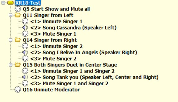

Now the MP3 player should simulate an actor and I want to mute channel 1 & 2...
It doesn't work with network send (I bought a paid extension of SQS), the XR18 probably has different protocols than the X32.
There are also two profiles for X32 in SCS, one normal and one for compact.
To be sure I don't have an error, I created a new SCS and connected my X32 Compact.
It works great with network send commands, tested it with mute.
I would very much like to use network send commands and not MIDI.
The way you do it in the example it probably works very well, I will test your suggestion on Sunday.
It's clear, I've now bought the expensive XR18 and I have MIDI support via USB host, I don't need an extra MIDI cable
However, I would be very happy if
@Mike who would implement XR18/16/12 in SCS.
Thanks all Erwin

I can now describe how the setup works:
1. Network Send is not an option as I connect the X-Air 18 to the Behringer X-Touch to be able to intervene live,
the X-Air 18 can only handle one interface, either Ethernet or Access Point. So Ethernet = Network Send is not possible.
The central question was: can X-Air 18 simultaneously receive audio from SQS and Midi-Send commands on the USB host?
And I can answer that with a definite YES.
The setup looks like this:
Shortly before the start of the show, all the microphones would be muted because the actors were still fitting and speaking backstage.
Then the first singer appears on a staircase to the left of the stage and sings the first song.
Playback only needs to be heard on the left speaker. (AUX5)
Then a second singer appears through a door to the right of the stage and sings the second song.
The playback only needs to be heard on the right speaker. (AUX6)
Then the third song starts and both singers run together to the middle of the stage.
The playback must be heard on all speakers. (AUX5 & AUX6)
After the third song, the moderator appears from behind, greets the audience and introduces the two singers.
>>> It all works great once it's understood and set up correctly
