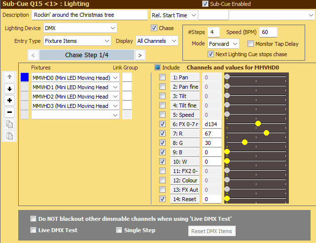

If the Chase checkbox is selected then some changes are made to the screen layout as shown in the following example:

Chase-specific fields are as follows:
#Steps: This defines the number of steps in the chase and must be between 2 and 8 for SCS Professional users, or between 2 and 24 for SCS Professional Plus and Platinum users. The default is 4.
Speed (BPM): The required speed of the chase in beats per minute, which must be between 1 and 480. This defines the duration between successive steps, so 100 BPM translates to 600ms between steps. The default is set to the Default Chase Speed (BPM) as set in Production Properties / Run Time Settings. See also Monitor Tap Delay (below). Hint: You can also set the Speed (BPM) field using the Tap Delay keyboard shortcut (default Ctrl+.) even if you have not selected Monitor Tap Delay, and even if focus is not currently on Speed (BPM).
Mode: This defines how the chase moves. The options available are Forward (default), Reverse, Bounce and Random.
Monitor Tap Delay: If this checkbox is set then when the cue is running SCS will set the speed according to the current tap delay time as set by the use of a keyboard shortcut (default Ctrl+.) or by a nominated MIDI or Network message. Taking the keyboard shortcut as an example, the tap delay time is set by averaging the delay time over 3 or 4 consecutive presses of the shortcut key, where the time since the last key press is less than 1.5 seconds.

Next Lighting Cue stops chase: If this checkbox is selected the the chase will be stopped when another lighting cue is started. Note: A DBO lighting cue will always stop a chase.
Chase Step: In the above screenshot you will see this displayed as 'Chase Step 1/4', ie step 1 of 4. This indicates that the DMX Items and DMX Value fields are for Chase Step 1. To view or edit the DMX Items and DMX Values for Step 2, click the > button to the right of the Chase Step field. You can obviously then click the < button to go backwards through the DMX Items and DMX Values for earlier steps.

The Fixtures and Link Group are as specified under Lighting Cues. For a chase Lighting Cue, these fields can only be set in Step 1 of the chase - they are common to all chase steps.
Channels and DMX Values
The Include and DMX Values can be set differently for each chase step.
Other
Do NOT blackout other active channels when using 'Live DMX Test': See Lighting Cues.
Live DMX Test: Select this checkbox to immediately view the effect of the chase.
Single Step: This is similar to Live DMX Test except that only the DMX for the currently-selected step will be sent. To view the next step, click the > button.
