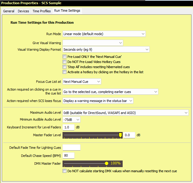

The Run Time Settings tab looks like this:
Run Time Settings for this Production

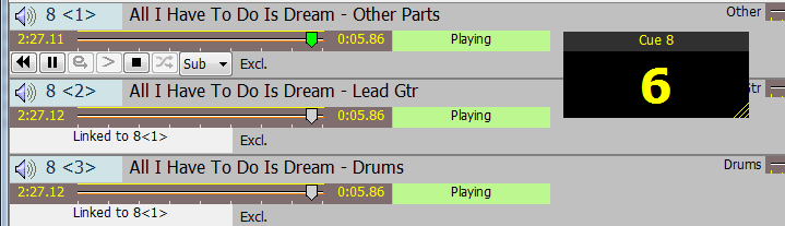

Example:
In live running you would probably not show the Sub-Cues for backing track cues like this.

Pre-Load ONLY the 'Next Manual Cue': This may be useful in a music production if you have many sub-cues for a music cue, and you are not needing to pre-load the following cue until the current cue has completed. By ticking this checkbox SCS will only pre-load the files for the 'Next Manual Cue', and then only pre-load them when any currently-playing cue has completed. This helps reduce the runtime memory requirement of SCS.
Do NOT Pre-Load Video Hotkey Cues: SCS normally pre-loads all audio and video hotkey cues so that they are available for 'instant' playback. However, pre-loading video cues can take significant resources, and if you have a lot of video cues then the video playback library (eg TVG) may fail to pre-load some cues. This can have an impact on other video cues that are not hotkey cues, because if the video playback library cannot open any more video cues then that may affect any video cue that's not currently open but needs to be opened for playback. So if SCS cannot open some video cues because you have too many video hotkey cues, then try setting this runtime property. Note that you may need to close and restart SCS for this to take any significant effect, especially if SCS has already failed to open some video cues.  Although there may now be a slight delay in starting a video hotkey cue, tests have shown that this delay is quite small, especially when using TVG.
'Stop All' includes resetting hibernated cues: The 'hibernation' of cues was originally designed to allow you to set up a playlist for pre-show music, fade-out and 'hibernate' it during the first Act, and then resume that hibernated playlist for intermission music. If, during the first Act, it is necessary to 'Stop All' then this would not affect the currently hibernated playlist, meaning that at Intermission your playlist may be resumed.
However, if you are hibernating cues for other reasons then you may require any currently hibernated cues to be reset to 'Ready' on 'Stop All'. This may apply particularly during rehearsals when you are more likely to using 'Stop All'. This checkbox ('Stop All' includes resetting hibernated cues) enables you to select this action.
Focus Cue List at: If the visible portion of the cue list in the main window is not high enough to display all your cues then a vertical scrollbar will be displayed which will enable you to scroll to view any part of the cue list. However, during normal production running you do not want to have to do this so SCS auto-scrolls the display as you progress through your cues. By default, SCS 'focuses' the scrolling around the Next Manual Cue, which means your next manual cue will be around the middle of the visible area (unless the cue is near the beginning or end of the list).
In some productions you may be more interested in having SCS focus the scrolling around the Cue Currently Playing, especially if you have many auto-start cues and the next manual cue is often a long way down the list. This can be implemented by selecting Cue Currently Playing from the drop-down list. If there is more than one cue currently playing then SCS will attempt to keep all the playing cues visible, but gives priority to the cue that was most recently started.
Action on clicking on a cue in the cue list: If you click on a cue in the cue list in the main SCS window, then by default SCS will 'go to' that cue, which means that the cue you click on becomes the 'next manual cue' and all preceding cues will be marked as 'completed' unless they are currently active. Actions available are:
Go to the selected cue, completing earlier cues. Default action as described above.
Set 'Go' button to the selected cue, but do not 'go to' the cue. The 'Go' button is set to the selected cue but basically nothing else happens. If you then click 'Go' (or equivalent) then SCS will 'go to' the cue and start playing it. This action is useful if you have SCS playing fairly much unattended, but need the facility to allow users to jump to a new cue, but also want to avoid the cue list stopping if the action was accidental, and the user didn't follow-up the click with a 'Go' action. Note that if you use a touch-screen then touching the cue list is equivalent to clicking on the cue list, so the possibility of accidental clicks or touches can be quite high in a busy environment.
Ignore the click. As the action implies, this will cause SCS to totally ignore any click or touch of the main cue list. This could be useful in a situation where SCS is run unattended and should always run through the whole cue list - which may well have a 'GoTo' cue at the end to loop back to the start.
Action required when SCS loses focus: If you have another app running at the same time as SCS and you click on a window of that app, then SCS loses focus. This means that if you, say, press the space-bar to activate the next cue, then that space-bar press is sent to whatever app and window currently has focus. So SCS will, by default, display a warning message in the status bar if the SCS main window does not have focus. However, if you are controlling SCS exclusively from some external device then the warning is irrelevant and can be annoying. So this property allows you to dictate how 'lost focus' is to be handled. The options are:
Display a warning message in the status bar. This is the default action as described above.
Ignore 'lost focus' states. If SCS loses focus, no warning will be displayed. We recommend you only select this option if you are confident that it will never be necessary to activate SCS manually using the keyboard or a mouse click.
Run Time Audio Settings
Maximum Audio Level: The maximum level (volume) supported by DirectSound is 0dB so that is the default maximum level used in SCS. However, if you are primarily using ASIO drivers then you can set the Maximum Audio Level to +12dB if you wish. This will enable you to amplify sounds, but be careful with this as you may introduce distortion. If you select +12dB when you are using DirectSound then the results of using a level greater than 0dB are undefined. Possible results are that the level will be capped at 0dB, or you may actually get amplification, or you may get distortion. So this setting is designed primarily for ASIO.
Minimum Audible Audio Level: The audio level below which SCS will cut out the audio playback signal. The default setting for new cue files is -160dB, but you can alternatively select -120dB. We recommend you select either -120dB or -160dB. Prior to SCS 11.8.3.2 the minimum was -75dB, and if you have a cue file that was last saved prior to 11.8.3.2 and have audio fade outs specified, then the fade out behavior may be different with the change to -120dB or -160dB. So for cue files last saved prior to 11.8.3.2, this minimum is set to -75dB to retain the fade out behavior where applicable. You may, however, change this.
Keyboard Increment for Level Faders: When you click on a level fader the fader then has focus, which is indicated by the background color being changed to a light blue. When a level fader has focus you can use the keyboard arrow keys to make minor adjustments to the level. This field determines what those minor adjustments will be, and by default this is 1dB. Note that you can hold down an arrow key on a fader to make larger changes.
Master Fader Level: This Production Property is where the default (or initial) Master Fader setting for this production is stored. You can adjust this default or initial Master Fader setting by dragging the slider.
Run Time DMX Settings
Default Run Time DMX Fade Time for Lighting Cues: You may enter here a default Fade Time to be used when running a Lighting Cue. This will be used for DMX items that do not have a fade time specified, provided the Lighting Cue has Use production default selected for 'Default fade time for the above items'. See Lighting Cues for more info.
Default Chase Speed (BPM): If you have any Lighting Cues that use the chase option then the Default Chase Speed in beats per minute (BPM) is initially applied, and will be the chase speed initially set for any new Lighting Cue with chase. The default value for Default Chase Speed (BPM) is 80.
DMX Master Fader: This Production Property is where the default (or initial) DMX Master Fader setting for this production is stored. You can adjust this default or initial DMX Master Fader setting by dragging the slider.
Do NOT calculate starting DMX values when manually resetting the next cue: If you manually select the next cue, eg by clicking on a cue in the main window's cue list, SCS attempts to calculate the DMX values that would be active immediately prior to your playing that next cue. This is basically performed by scanning all prior Lighting Cues and also Call Cues that call Lighting Cues. This is ideal for rehearsals if the director wants to rehearse a part of a scene - possibly several times. If you do not want this calculation to occur, possibly because you are heavily reliant on the use of hotkeys for the current production, then you can disable the feature by selecting this checkbox. See also the Run Time Note under Lighting Cues.
