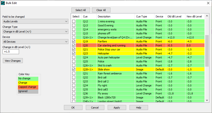

View Changes: This button is only displayed if the above field is a text field, as the button is not required for changes to other field types. This is because changes made by changing the state of a checkbox or selecting an entry in a drop-down list can be immediately used to populate the 'New' value in the main table. Clicking the View Changes button is a convenient way to indicate that you have completed entering your change, although SCS will actually regard the entry as completed if you click (or tab) anywhere out of the text field.
The Device column shown in the above screenshot is only included if the Field to be changed is set to Audio Level. For all other field selections, this column is replaced by Activation, eg Manual, 1.00 ae Prev, etc.

Color Key: In the main table in this window colors are used to clearly show you what will be changed when you click the Apply button or the OK button. The colors used are as follows:
 No change
The item will not be changed, or is not selected.
 Change
The item will be changed.
 Capped change
The item will be changed but the amount of the change will be capped to prevent the new value being out of range.
 Ignored
A requested change to this item cannot be processed. This should only occur for Normalization requests where no file statistics have been collected by SCS. The most likely reason for this is that the duration of the audio file is greater than the maximum length for a file scan as specified in the Editing Options.
