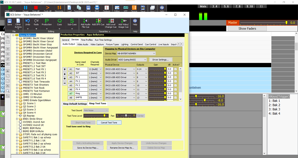

I'm having a problem with my output device. I have a "Main" multichannel audio output with 11 channels. Next to that I want to able to send single audio to those different channels so I created multiple mono outputs and routed them to corresponding outputs. But when I play a test tone on a mono channel it keeps getting send to only the main 1 and 2 outputs instead of the output I selected. I couldn't find the Diagnostics function in the help menu. But if you need more info please let me know. I attached a printscreen showing me trying to put a continuous test tone on my output labeled "Ring" but the meters on the main are showing a signal. It used to work in previous versions, because this is an older showfile I created one year ago, and updated when neccesary. When I remove the "Main" output everything works fine.

I think it may be due to SCS having to combine ASIO channels. To help me investigate this further, please email us the log file from a run in which you played the test tone. Log files are saved in a folder named "SCS Logs" under "Documents". Email the file to support@showcuesystems.com.

I've sent you a new version that should fix this issue.
