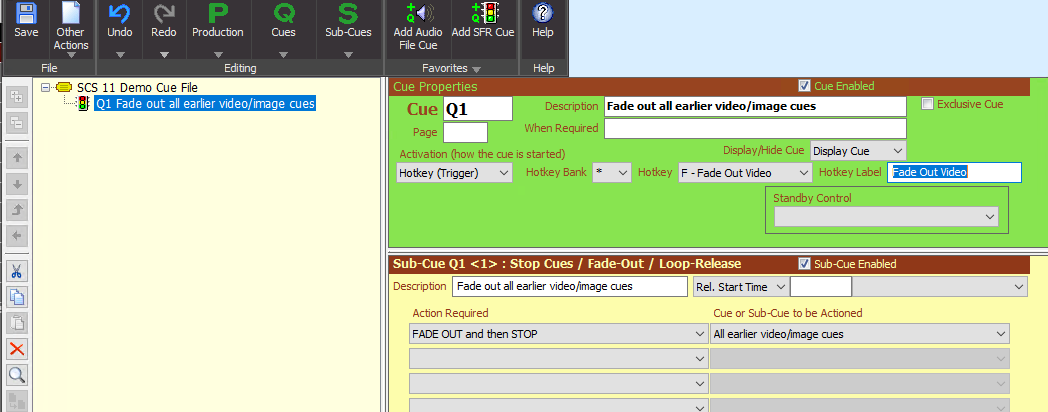

Post by Buyaicia » Thu Aug 31, 2023 10:39 pm
You can create a SFR cue with the action "FADE OUT and then STOP" to "All earlier video/image cues"
And add activation mode to hotkey.
Maybe this helps.

How about a SFR cue with the action "FADE OUT and then HIBERNATE" to "All playing video/image cues"?
Restore with "RESUME hibernating cue (with fade in if applicable)".
I haven't tried it, so I have no idea if it works! RESUME may not like the possibility of more than one image being hibernated.

Post by Nino » Fri Sep 01, 2023 4:00 am
This one does seem to do the job!
