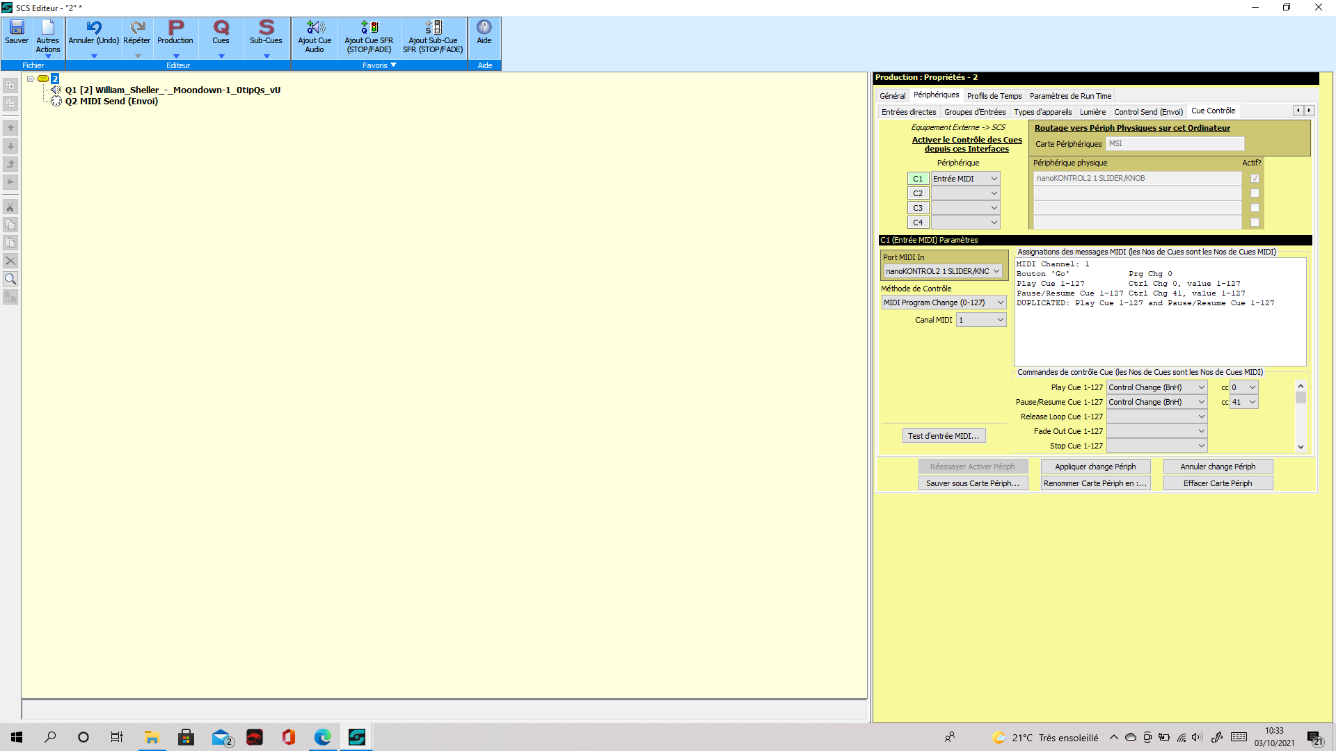

Good evening I would like to use control change on my NanoKontrol to send 2 control cue commands: for example cc0 for a go st cc 1 for a stop but a message appears: DUPLICATED play cue 1-127 and pause resume Cue 1-127. I can't seem to duplicate.

Does the information displayed under 'MIDI Message Assignments' help explain why duplicates are reported? If not, please email me the log file from a run in which this message was displayed. A log file will have been created and saved in a folder named "SCS Logs" under "Documents", and the name of the file includes a time-stamp indicating when the log started.

Post by Thierry » Sun Oct 03, 2021 6:47 pm
Capture d’écran (126).png (146.98 KiB) Viewed 767 times

I suggest you set the 'Control Method' (Méthode de Contrôle) to Custom. Then scroll down the list of 'Cue Control Commands' (Assignations des messages MIDI...) and set the required cc commands against 'Go Button' and 'Stop Everything'.

Merci ça marche .
