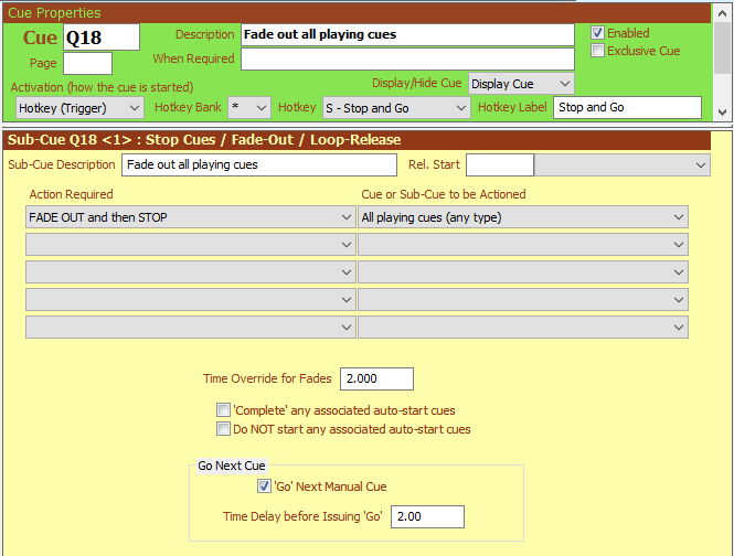

Mike, is there an option for Fade All Playing Cues as well for the Hot Keys? That would be ideal for some of my situations.
Re: Programming issue with Hot Key
Post by Mike Daniell » Wed Aug 31, 2016 3:45 pm
Yes, just set up your hotkey cue like this:
