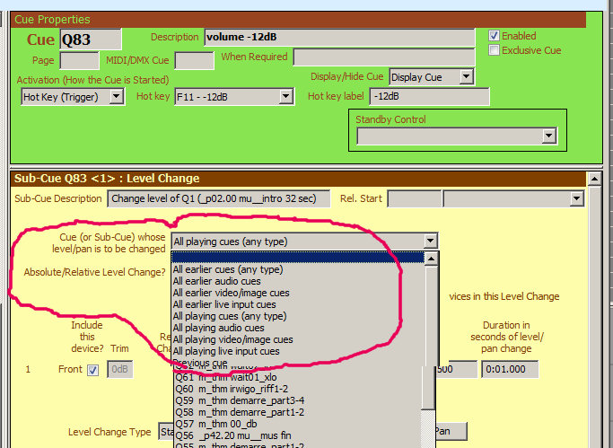

Second suggestion is something i would love : i use hotkeys all the time, for stop, and for fade out, so i'd love to do the same for 'Level change'. Do you think it could be possible to add a choice in 'Level change menu/Cue or Sub cue whose level/pan is to be changed' : All earlier cues / all playing cues etc. (just as it appears in 'Stop/Fade menu'.
That would allow to change levels of any current playing cue 'on the fly'.
See in here joint file how this function could be integrated Regards

I'll consider this for a future enhancement, but note that you can already use the shortcut keys Shift+F11/F12 to decrease/increase the levels of all playing cues.mwfr wrote:Second suggestion is something i would love : i use hotkeys all the time, for stop, and for fade out, so i'd love to do the same for 'Level change'. Do you think it could be possible to add a choice in 'Level change menu/Cue or Sub cue whose level/pan is to be changed' : All earlier cues / all playing cues etc. (just as it appears in 'Stop/Fade menu'.
