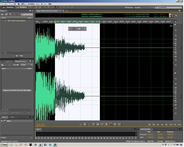

Waveform end zoomed.jpg (99.96 KiB) Viewed 559 times
This .wav file cuts off during the fade for me regardless of what I am using to play it. I've used SCS 11.2.6, the dropbox link in Firefox and Adobe Audition CS6. It's consistent with every playback software. Take a harder listen to it when you play it in Windows Media Player.
I zoomed in on the waveform end in Audition and attached the image to this post. As you can see the end fade is chopped off. You should listen to the source CD and see if that is how the song ends. On the CD, if there is a song after that, does that song begin as this one fades?

Thanks for your thoughts on this. The .cda plays fine, doesn't cut off and is not cross faded into the next track. The 'solution' I've found seems to be simply using a 'better' ripper. This WAV was created using EXACT AUDIO COPY by NCH - https://dl.dropboxusercontent.com/u/139 ... k%2008.wav
As this screenshot shows - not chop at the end Image
Again, thanks for your time - it seems I will have to re-rip some files using better software to get acceptable results.
