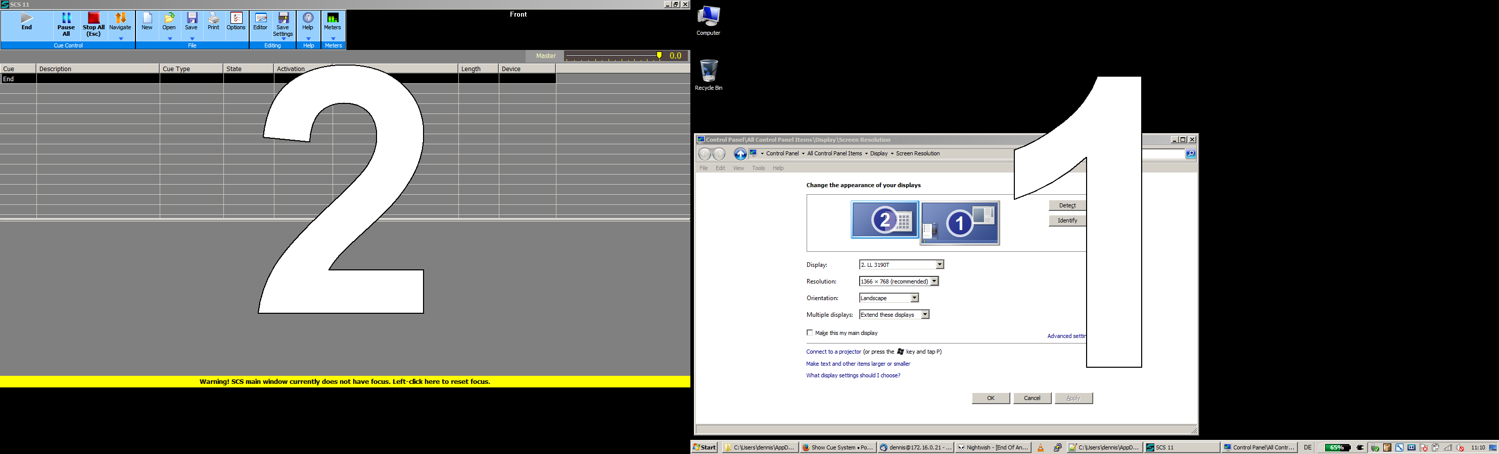

Short description:
If closed on a certain position the position of the SCS main window will not be restored on next start.
Affected versions:
Tested with 11.2.5 and 11.2.6n
Description:
The screen layout is pretty simple. Two screens with a resolution of 1280x768 each. SCS main window on the screen leftof the primary one.
However i was able to reproduce this at home with the layout configuration attached. (primary 1600x900 and secondary 1366;768)
If i close SCS the following window position will be saved:
Code: Select all
Main = Max;-1370;0
I expected x = -1366 there.
After opening and closing it again. The new position is now:
Code: Select all
Main = 404;140;792;560
I then changed the x coordinate to
Code: Select all
Main = Max;-1366;0
and it worked
However once closed, the saved position was again:
Code: Select all
Main = Max;-1370;0
So the current workaround was to not use a maximized window. If i use the following window position and size the window will be restored at the position as expected:
Code: Select all
Main = -1366;0;1366;768
Steps to reproduce:
Position the SCS main window on a screen left of the primary screen.
Maximize the window.
Close SCS
Open it again
Expected result:
SCS main window opens maximized on the secondary screen.
Actual result:
SCS main window opens centered at the primary screen with a width of 792px and a height of 560px.
thanks,
dennis
scs11dump_2014-03-22_113422.txt
(4.36 KiB) Downloaded 34 times
Re: SCS window pops up at wrong position
Post by Mike Daniell » Sun Mar 23, 2014 5:27 pm
Hmm. The maximized screen coordinates seem to be out by the window border size. I'll either try to compensate for this difference, or see if there's some way to get the real coordinates.
Post by Mike Daniell » Mon Jul 07, 2014 4:42 pm
A mod has been applied in 11.3.0 that should fix this issue.
