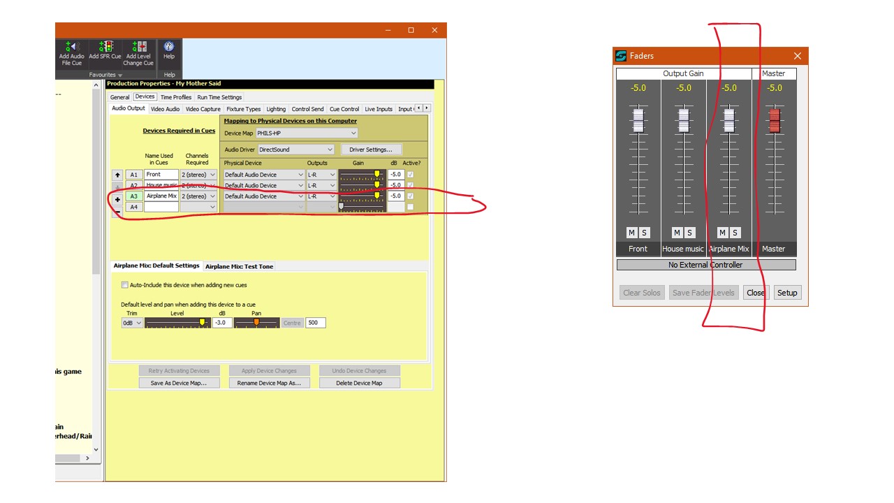

So I don't think what you're looking for is in SCS but I have run into the same and developed a couple of different approaches:
One way I do this is to send all those cues in that grouping to the same specific device. So my Audio Devices might look something like as shown in the attached JPG. Note that even though it's a seperate device it still goes to the same output as my FOH & House music.
I will then put my complex cues and sub-cues through that specific device and I can then control the overall volume maintaining the relativity of them through either the Device Faders (Show Faders - see also attached word document) or via the device screen.
Whilst not totally answering your requirement this approach does then allow you to reduce the overall level of the set of cues and works particularly well if you use an external controller, something like a BCF2000, through which you can then control the Device level. You can then either do it dynamically during the show if needed (as per your follow on comment). Or at rehearsal time and use the "Save Fader Levels" button to keep the end result.

Yes, I could do it that way, but that would need more output devices than I have available -- only 2 channels at the usual venue, 4 if I use the headphone output of the laptop (yuk). Unfortunately there are no Win10 or 11 drivers for my Tascam US122.
If I was using my X32 then it would work very well, but for most of these shows we are using the local Qu24 desk (X32 won't fit in the control room), so I'd need a multi-channel audio interface or I'd need to configure the Q24 desk USB interface but we're short on time to set it up as I'm mostly erecting the set up to the start of the tech - I just don't have the time so get it all working.
Also I'm often not there for the get-out and no-one else would be able to put the mixer back as the venue wants it (they've lost their resident tech due to some internal politics)
It would be much quicker and convenient SCS could do it all in software.

But while SCS doesn't have a cue to adjust the device level then my solution will work (trust me I've done it), even with only the physical 2 outputs - Note in my original attachment Airplane Mix is sent to the same physical outputs as the FOH & House devices, so you can have multiple SCS output devices going to the same physical place, but you get control of each one through the faders on SCS. (Incidently this is something some other cue playing software does not have.)

Tried your first suggestion (had to use the BASS mixer to see the faders of course) and it works fine if there are only a few multi-subcue cues, so thanks for that.
I just created another one for a storm, which has 4 subcues running simultaneously - so had to add a new device. The problem with that method is that you either have to anticipate in advance which "grouped" cues will need a master fader and which won't - ad you might end up with a dozen or more; you can't add new devices on the fly during, for example, the dress rehearsal when the director sticks his head in and asks for a different level from what was set in the tech, when you have other cues to run and a script to follow.
