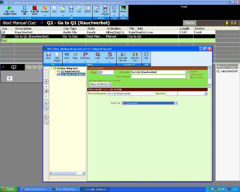

You can fire a Hotkey Cue by pointing a Goto Cue to it, like this:
HTH Jörg
HTH Jörg

Firing a hotkey with Goto changes the next manual cue position as well. An obscure work around which is fine for "small" subroutines is to use BOME Midi Translator (or equivalent) which can convert midi messages to key presses. So you create a hotkey cue to execute your subroutine and then send a midi message out of SCS to BOME (via a virtual midi port), which creates a key press to execute the hotkey cue leaving the next cue pointer in the right place . . .

Of course "Goto" will change the cue position. One can use more gotos, which will create something, what programmers call "spaghetti code".
