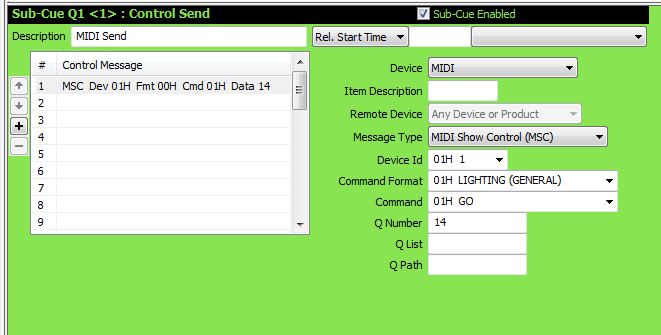

Hello Mike and all,
we run ito following problem:
When trying to send MSC, the transmitted command format is always set to 00H, changing and sving is not possible. Problem exists since at least 11.9.0rc7, 11.8.5 works fine.
Log and screenshot attached.

Jörg, that was fixed in SCS 11.9.4. I recommend you download and install 11.9.5.
