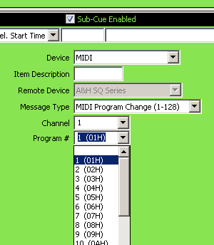

currently we use SCS 11.8.3.4(x64) and a Allen&Heath SQ-6 sound mixer.
Sending MIDI Program Change works fine as follows:

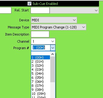

Today I tried the new SCS 11.9.0(x64), but there are problems with sending MIDI Program Change commands:
the codes are shifted by one (similar to the other list 0..127):

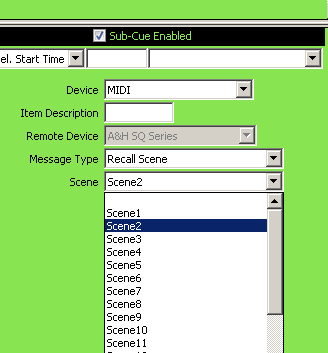

Also there is a similar problem with the new SQ series device.
Using "Recall Scene" it doesn't matter which scene number is selected, the MIDI code B0 00 00 C0 00 is always sent!

Post by Mike Daniell » Fri Apr 08, 2022 12:06 pm
I've emailed you a link to a version that should fix these errors.
