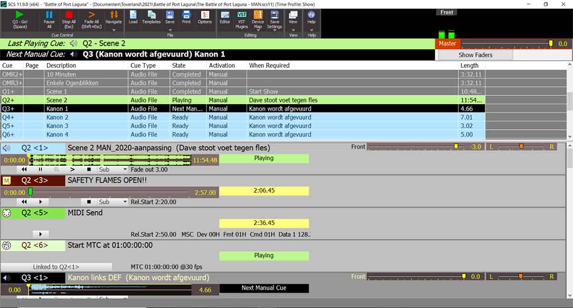

Hello,
When starting an audio cue with a MTC sub-cue the audio timerclock isn't running and no MTC is running and being send to the MIDI Out device.
In this screenshot I already had the cue running for a couple seconds but as you can see no timer is running. You can hear audio playing but that's it
2022-03-20 (2).jpg (97.31 KiB) Viewed 7453 times
Regards Stan
