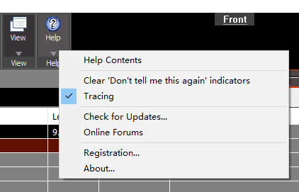

P.S. I can not find an option under Help to create a Diagnostic File. And I can't upload .scs11 files to forum directly because the website prompts: 'The upload was rejected because the uploaded file was identified as a possible attack vector.'
I can not find an option under Help to create a Diagnostic File.png (8.78 KiB) Viewed 3296 times
