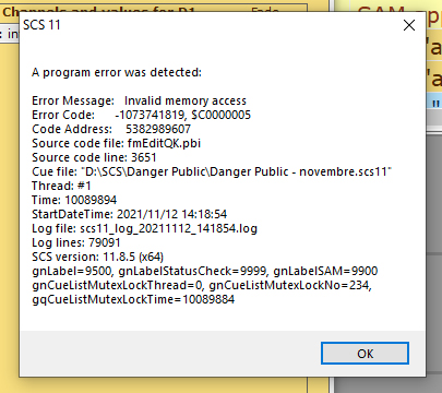

Hello,
I have a crash in the editor, in the properties pannel of any lighting cue when I change the "display" combo box from "All channels" to "1st channels".
I'm using a Focusrite scarlett 8i20 USB sound card and the ENTEC DMX USB Pro MK2.
crash message.jpg (137.11 KiB) Viewed 1482 times
I have sent the log file by e-mail.
Yhank you in advance,
Michel

Michel,
As I mentioned in my email reply, I can't reproduce this error. I've extracted your cue file from the log file, and in the editor clicked on Q39 (the cue you were accessing when the error occurred), and I can successfully switch between 'All Channels' and '1st Channels'. Maybe something in the history of that run upset something in the editor, but it would take me a while to investigate this. If you restart SCS, can you now successfully switch to '1st Channels'?
