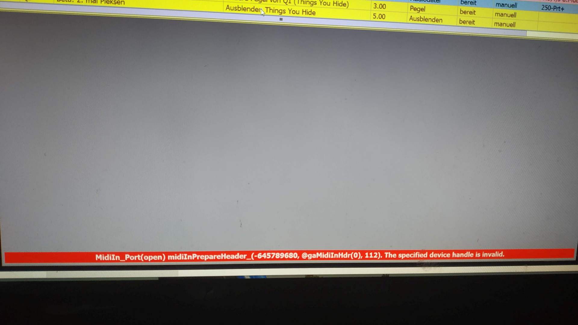

Condition: SCS show with many audio and FHD video cues and midi MMC control activated.
If I let too many FHD videos preload in this show and the memory consumption of SCS rises above 1GB in RAM, SCS reports "MidiIn_Port (open) midiInPrepareHeader _ (- 645789680, gaMidiInHdr (0), 112). The specified device handle is invalid . " If I limit the pre-loading so that after the start the memory consumption is less than 1000MB, everything is fine and midi works.

Post by Mike Daniell » Fri Sep 25, 2020 11:16 am
A log file will have been created and saved in a folder named "SCS Logs" under "Documents", and the name of the file includes a time-stamp indicating when the log started. Please email me the log file from a run that displayed this error.
