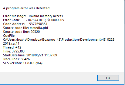

SCS version: 11.8.0.1 (x64)
I'm not sure what is causing the error, but I've sent a diagnostics file to Mike.
Patrick

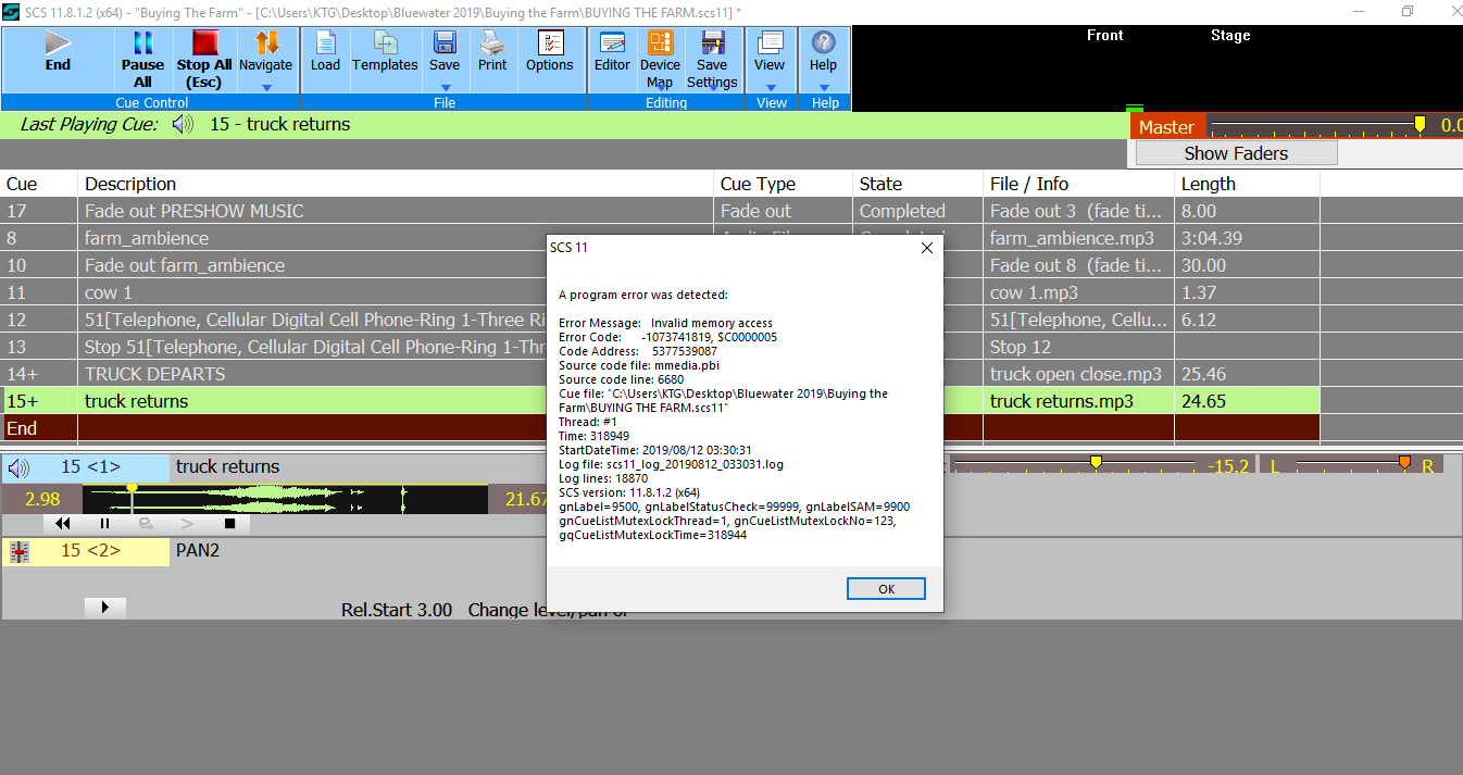

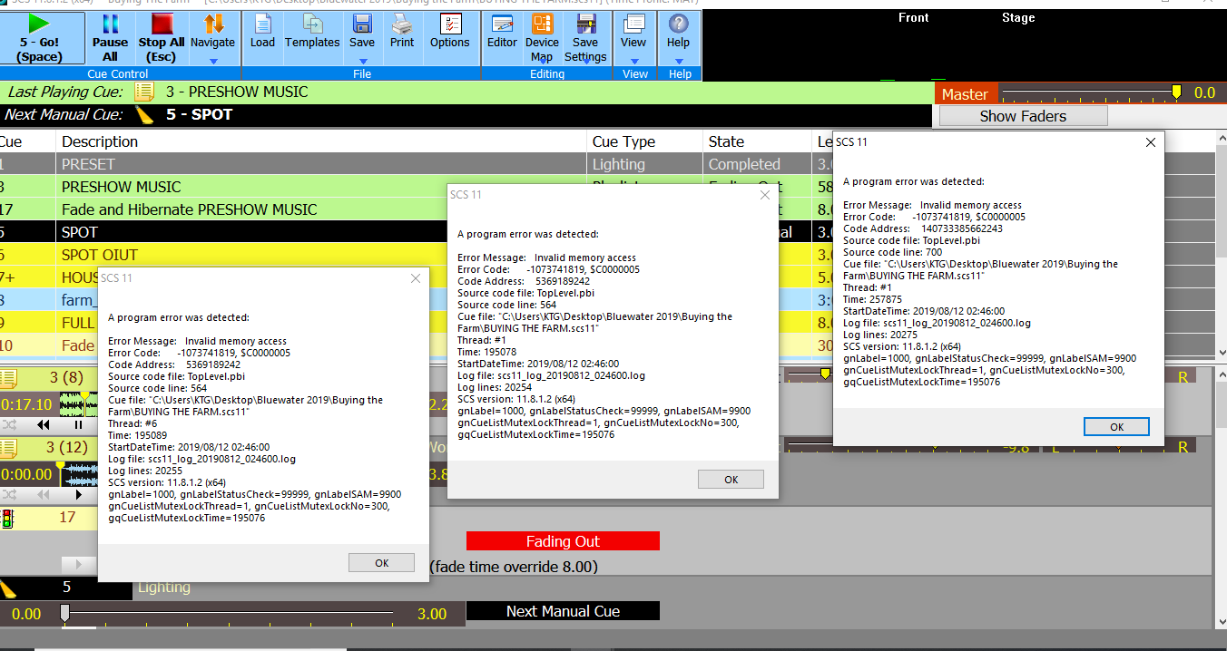

this has been happening to me all night. I have a level set in the morning and I can't get the program to be stable. I thought it was lighting cues, but no, it crashes when playing a single mp3 file. I will re-format the files and see if that is whrt is fouling up the works.
scs11_log_20190812_033724.zip
(147.21 KiB) Downloaded 68 times
ERROR SCS.PNG (111.08 KiB) Viewed 1485 times
ERROR SCS again.PNG (76 KiB) Viewed 1485 times
smacks999
Posts: 20
Joined: Sat Aug 17, 2013 8:55 am
Re: SCS 'invalid memory access' error
Post by smacks999 » Mon Aug 12, 2019 5:55 pm
and another log file
scs11_log_20190812_033031.zip
(218.32 KiB) Downloaded 58 times
Post by Mike Daniell » Mon Aug 12, 2019 7:01 pm
It seems these errors were caused by the second sub-cue of cue 15. This is a level change sub-cue, but unfortunately the sub-cue seems to have been corrupted as the "Cue (or Sub-Cue) whose level/pan is to be changed" is currently blank. SCS should not have allowed that field to be left blank, but that's what's throwing the error when you try to play cue 15. Do you recall any changes you made to that sub-cue?
To fix this, just edit this level-change sub-cue to enter the required cue or sub-cue, and check that other details are as you require. Alternatively, if the sub-cue is obsolete just delete it.
