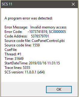

Hi!
Having a video file following an empty "[Placeholder]" audio playlist as sub-cues crashes SCS for me.
Steps to Reproduce:
(in the editor)
  • Cues -> Add Playlist Cue
  • Cancel, and "Yes" to create placeholder.
  • Cues -> Add Video/Image Cue
  • Find a video, add it.
  • Select the video cue, and press the "⮥" to join the two cues together
And I get a crash, the error dialog is attached. The text is:
Code: Select all
SCS 11
A Program error was detected:
Error Message: Invalid memory access
Error Code: -1073741819, $C0000005
Code Address: 5376579701
Source code file: CuePanelControl.pbi
Source code line: 1559
CueFile:
Thread: #1
Time 31649
Trace lines: 5355
SCS version: 11.8.0.1 (x64)
The logfile is also attached.
Daniel
scs11_log_20190316_114350.zip
(78.57 KiB) Downloaded 45 times

Post by Mike Daniell » Sun Mar 17, 2019 2:32 pm
Fix ready for SCS 11.8.0.2 - I've emailed you a download link for a pre-release of this version.

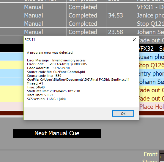

I have a similar problem. I just created a cue file (132 cues) with a number of 'place holder' cues of various sorts: playlist, audio and video/image cues. No problem creating the cue list - but coming out of editor and running the show it crashes. Error message attached. Cue file also attached - error occurs raround Q80 - 82 depending. Running SCS 11.8.0.1 (x64).
Cheers
Ron Balmforth
SCS crash.png (38.3 KiB) Viewed 830 times

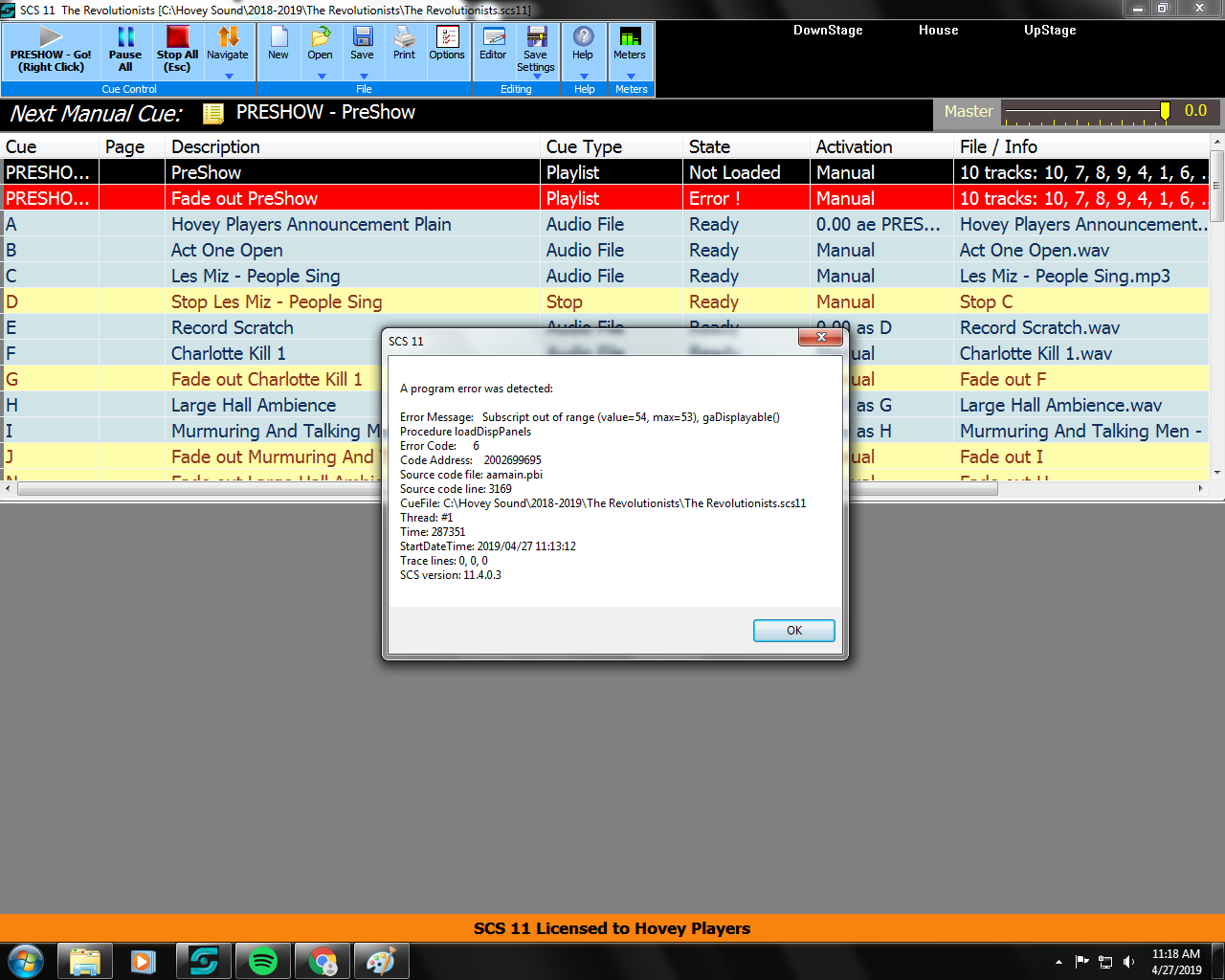

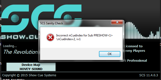

I am having the same issue. I built the show and it ran fine. I came back 24 hours later and the program won't let me in.
Running 11.6.0 I get this first screen, then the second, then the program crashes. No way to fix the issue, just dead in the water. :( I'm supposed to start tech in an hour.
Thanks.
When open program
When click OK on previous, see this then program crashes
