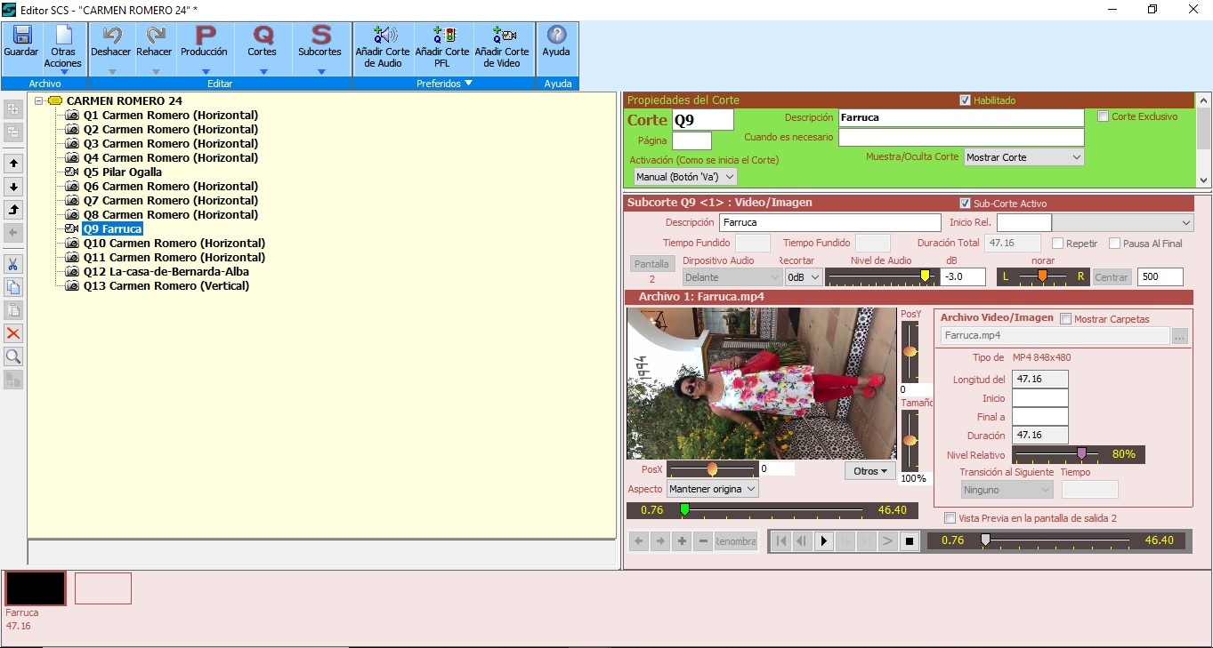

Hi. I am using scs 11.7.0 and I'm having a problem with a video.
The video is rotated in SCS, while is played fine in VLC, Windows movies&tv, and windows media player.
This is the video: https://drive.google.com/open?id=1Vy6zo ... QGq_Nl-Vi9
Attached is the image of the same video file in show cue system.
I am new to the software so I dont know if there is any option for rotate/flip videos...but I can not find it.
Thank you.

It seems that the video playback library TVG (TVideoGrabber) is not automatically rotating the video. The width of the video image is 848 pixels and the height is 480 pixels, and that is exactly how TVG displays it. I ran this through the TVG demo program and got the same result as SCS.
However, I then 'converted' the MP4 file to MP4 using the NCH Prism Video Converter, and Prism rotated it without me having to request this. So after this 'conversion', the new video plays correctly in the TVG demo and in SCS. The new video image width is 480 pixels and the height is 848 pixels.
I haven't provided a rotation option for videos but will consider this for a future release. Meanwhile can you re-save or convert this file to fix the rotation?
