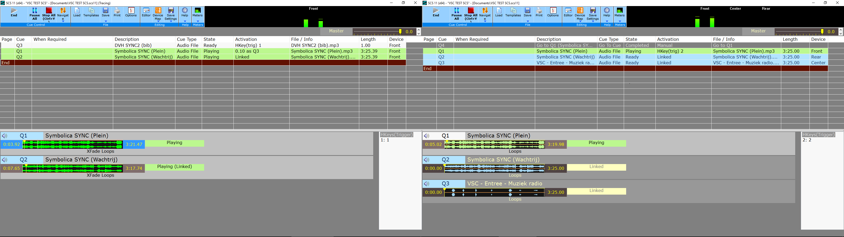

I use SCS 11.6.2.1 on a Windows 10 (x64) computer.
I've found a few small problems with linked audio cues.
When 2 audio files are linked to each other they start playing together.
But when I add a Cross-fade loop in both files, something goes wrong.
The first time de audio loops everthing is OK. But the second time, the first file will loop correctly and the second file will start from a later point in the audio than the first.
This repeats all the time, the audio is not playing sync anymore.
When the first file is a Hotkey Trigger, The other audio files will not play if they are not selected.
So if you press the hotkey while the cues are ''ready'', all the files will start playing. If you press the hotkey again, the first one will restart, the others won't.
It would be great if there is a possibility to Link audio cues within a folder (so link multiple subcues)
Or if ''LINKING'' was an option in the edittor of the audio file, or if you could select the audio which you want to link the audio with.
LEFT = Xfade bug RIGHT = Hotkey trigger problem
Schermopname (7).png (112.58 KiB) Viewed 525 times

Lars,
I see from the window title bar that you're using a tracing version of SCS. Could you email me the log file from this run or a similar run? That will save me a lot of time in trying to reproduce the errors.
