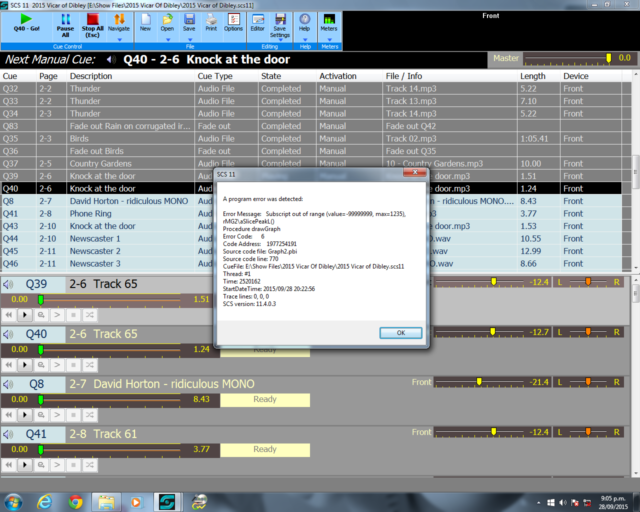

The error is a "Subscript out of range" with procedure "drawGraph". This error causes SCS to crash and cannot be restarted immediately after the crash (it reports that another instance is already running for up to 20 seconds). I haven't seen any particular pattern yet, this has happened a few times on two different machines, but it seems to be after editing the cuelist. This error doesn't happen if the cue list hasn't been edited, so I have taken to restarting SCS if I have been editing close to showtime.
Version of SCS: 11.4.0.3
After I posted last night I have realised that this error is not an invalid memory error. So I have reposted as a new subject. I have a screen capture attached of the error. I shall do the diagnostics file tonight and attach it also.

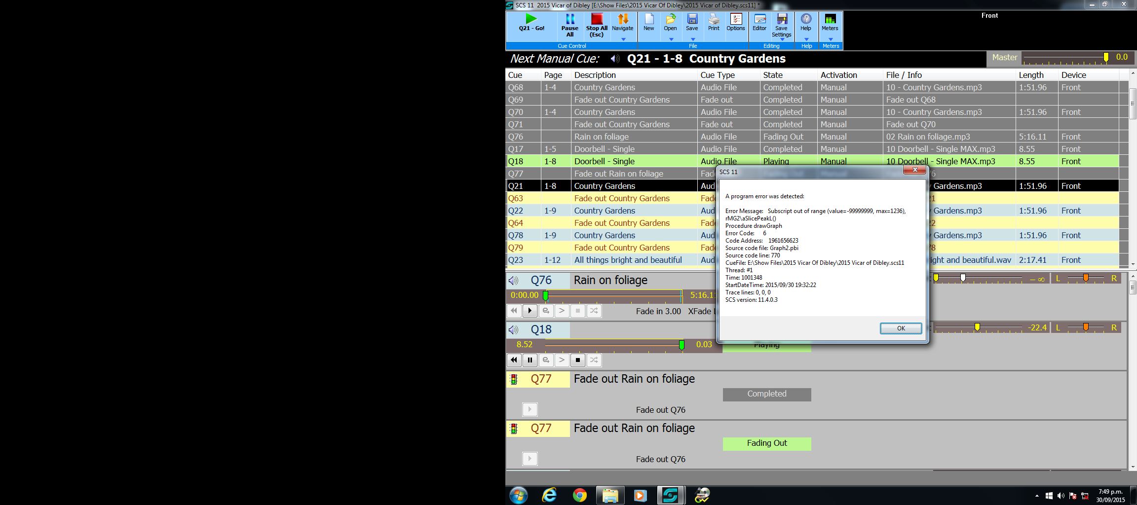

Caught the error and crash in the diagnostics file twice. I had been editing the start point of an audio cue just before it crashed.
I shall email the SCSZ files shortly, I am not allowed to upload them.

Mark,
I've emailed details of version of SCS that should fix this problem. The error occurred if you have an audio file cue selected in the editor, then play the cue from the main window, and leave the cue to play through to the end. The error occurred when SCS tried to reset the cue back to the start point.
