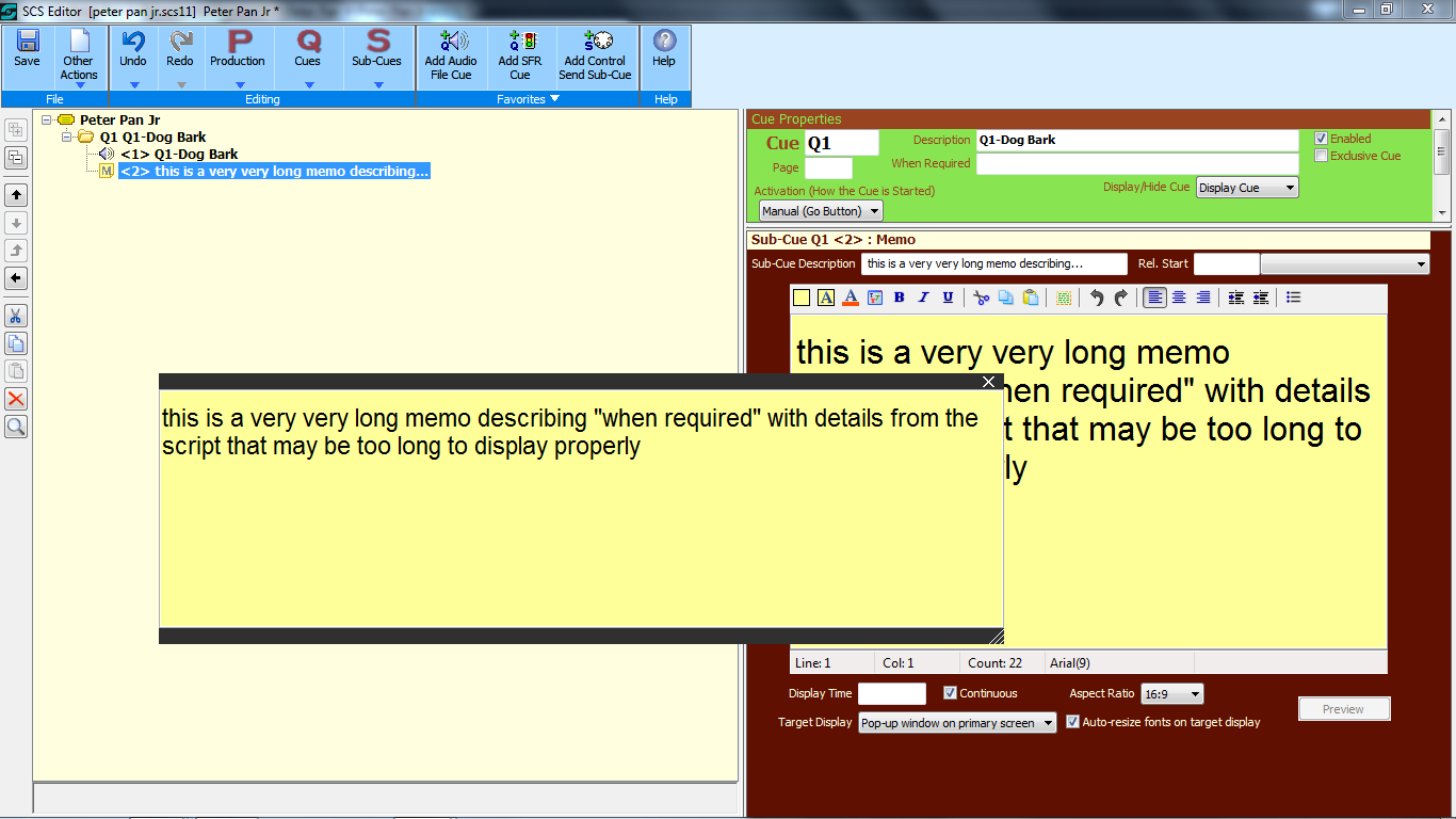

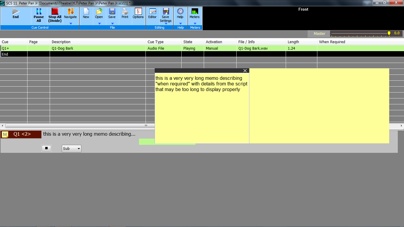

When I create a memo sub-cue and re-size the display box to be a long rectangle, using a large font size, the resulting box when running the cue is incorrect.
The box is created at the correct size, but the text display area only uses a portion of the box. See attachments.
Version 11.3.8
Memo Cue Display Box Sizing
- Run Screen Shot.png (79.43 KiB) Viewed 406 times
- Editor Screen Shot.png (111.53 KiB) Viewed 406 times

I found that I can work around this issue by unchecking the "Auto-resize fonts on target display" check box in the editor.
