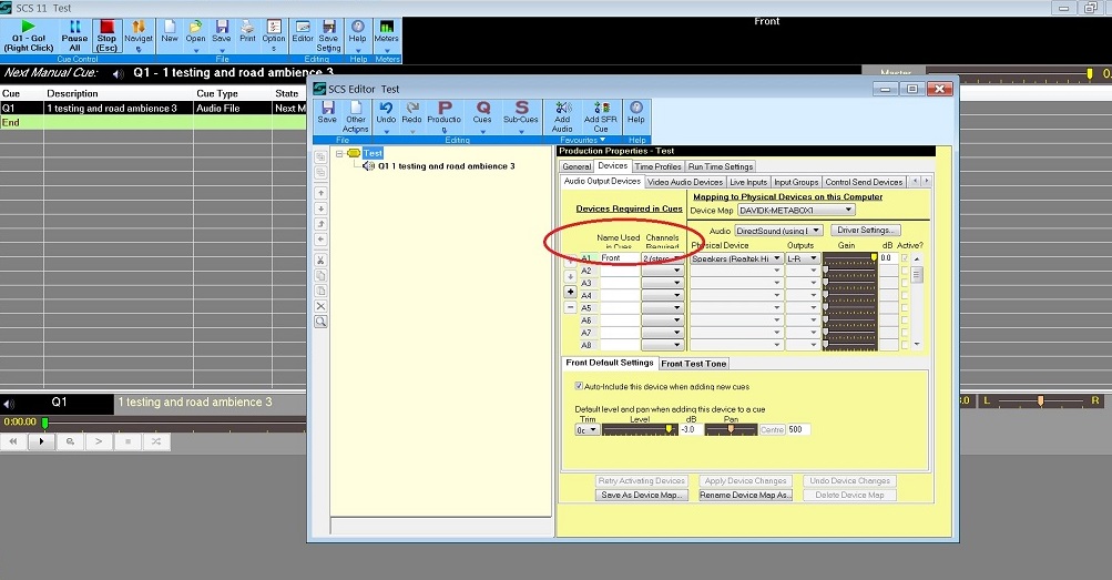

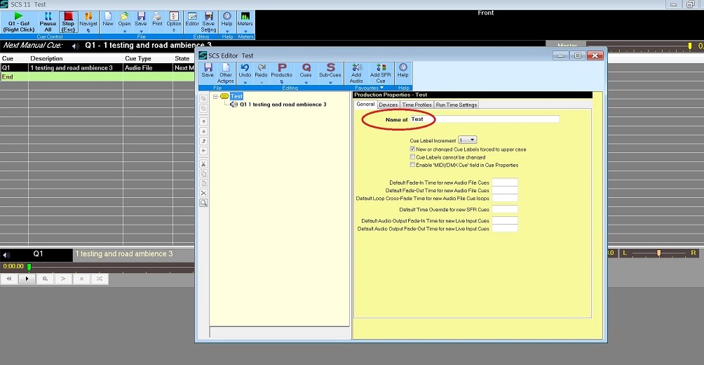

I'm a new SCS user and have run into a few issues I'm hoping you can help with.
1) The SCS GUI has a bad case of flicker / rapid screen re-painting on my laptop. It is most evident when I'm resizing windows but also when I open a new window, click on a cue in either the standard or editor windows, or even just move my mouse cursor around in the editor window without clicking anything. Eg. I click on a cue to load it causing the whole screen to flash a couple of times (including the grey background).
2) Some field info text in the edit window is obscured or cut off regardless of how large I resize the window. I have included a few screenshots of this issue.

- Example of obscured text is highlighted in red
- Text Cutoff 2.jpg (145.84 KiB) Viewed 1353 times
- Text Cutoff 1.jpg (121.62 KiB) Viewed 1353 times

My screen is set to 1920 x 1080, which is its native resolution. I found that the obscured text is caused by SCS not seeming to like the Windows 7 'Make text and other items larger or smaller / set custom text size (DPI)' settings. I have this set to 140%, which works well with all my other programs. When I set it to 100% SCS looks good and no text is obscured, however outside SCS the rest of my program windows and desktop icons are microscopic.
With 'Make text and other items larger or smaller / set custom text size (DPI)' set to 140% if I reduce the SCS font size the font gets smaller but the obscured text is not revealed.
Also, prior to messing with the SCS font size settings, the default size was 5pt. After messing with the settings SCS now thinks its default font size is 8pt.

Thanks for the diagnostic dump file. I will need to do more work on making SCS fully DPI-aware. The font scaling factor shown in the dump file appears to be incorrect for font sizing of 140%, so I'll look into that. Unfortunately I can't promise a quick solution.
Re: 11.2.3 GUI Flicker and cut off text
I confirm that the DPI issue is a bug and that currently SCS requires the Windows display setting to be 100%, not higher (eg not 125%). To correct this bug, SCS needs to be modified to use the scaling factor in determining window sizes, and individual text and control positions and sizes.

Text being cut-off has been fixed in 11.2.4 with the addition of DPI-aware processing.
