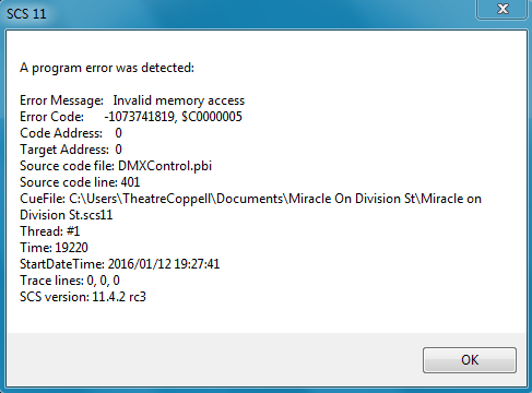

BritGeek wrote:If I forget to turn on the audio interface (Behringer FCA610 using ASIO) before starting SCS I get the message that the device cannot be initialized, as expected. If I turn on the interface and hit the "Try again" button it doesn't work, I just get the message again; I have to choose the "Close SCS" option and restart it in order for SCS to see the interface.
When I press the "Try Again" button in RC3 it now crashes. Diagnostic file and screen shot attached, let me know if you need more info - it's easily repeatable for me. I had to save the diagnostic file in a separate session because the crash occurs before I even get to the main screen.

Post by Mike Daniell » Thu Jan 14, 2016 3:48 pm
Memory error fixed in RC4.
