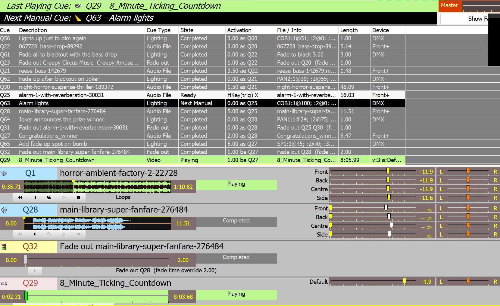

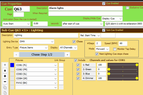

Cue 63 is called Alarm Lights and it is configured to auto start 0 seconds after the named previous cue. It is a chase. That previous cue is a hotkey, Q25.
Attached is a picture of the editor with the config of that cue.
When running the show, the cue correctly states it is ready for Auto Start and, indeed, fires automatically when Q25 starts.
A few seconds later, when the next lighting cue begins, it does duly stop as instructed by the configuration but then it determines itself to be a Manual cue, the row shows black and, indeed it sits there as the NEXT manual cue.
Now, that's a big problem because when I want to fire the next real manual cue about 20 cues later, I find this one is 'in the way' and reacts first.
My workaround is to press the spacebar TWICE at that point: the first press manually starts that old Alarm lights cue (undesirable) but the next press, on the real manual cue is another lighting cue, so it stops the Alarm Lights and proceeds to do what I need; but for having a half second flash of the rogue cue. Fortunately the manual setting of the Alarm Lights does not take the whole show back!

Right, I worked around this (and perhaps this helps highlight where the defect is) by adding a disable hotkey cue after the hotkey and then hanging the Alarm Lights off of that cue instead. Now, when the next lighting cue comes on, the Alarm Lights does not turn to the next manual cue.
So there is something wonky about the chase lighting cue following the hotkey directly which I recommend be explored. Can send logs if required.
