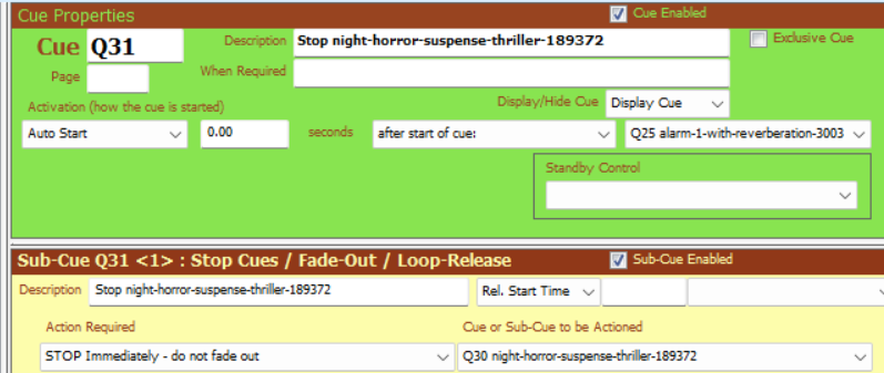

I have an audio cue that fires off the X hotkey.
The cue immediately after that is an SFR cue to immediately stop a running audio cue
This SFR cue is clearly labelled as Auto Start 0.00 seconds after start of cue [audio cue ref]
However, when playing in the show, this comes up as a Manual cue so the show stops.
I have tried to attached 3 screenshots.
1) shows the cue in the editor in its sequence (highlighted)
2) shows the config of that cue in the Editor
3) shows what it looks like when running (the black Next Manual" row)
I tried to recreate the cue and delete the offending one but I had the same issue; it kept declaring itself as a Manual Cue.
The only thing I could think was that an SFR is not allowed to follow a hotkey cue.
So I deleted the SFR cue and recreated it after the next audio cue so it was the SFR dependent on the audio not the audio dependent on the SFR
This appeared to work so I go around it.
I note that earlier in the programming I had altered the cue that this SFR was due to be referencing so i wonder if that messed it up.
