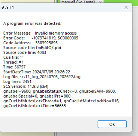

Hi Im Max,
My Scs crashes every time i try to create a lighting cue, after i prepared all fixtures and lighting devices it says error: "invalid memory access" when it tries to load my fixtures so im not able to create lighting cues :/ can you helb me?
i used scs 11.9.8(x64) first,
then updated to scs 11.10.2(x64) but it didnt change or solved the problem .
thank you for your help
max
max
- scs11_log_20240705_234537.zip
- log file with the same error but a newer scs version and try to wqork with artnet instead of the direct enttec open dmx
- (77.33 KiB) Downloaded 282 times
- scs11_log_20240705_230046.zip
- log file with old scs version
- (44.37 KiB) Downloaded 288 times
- error message screenshot
- scs fehler.png (96.6 KiB) Viewed 9797 times

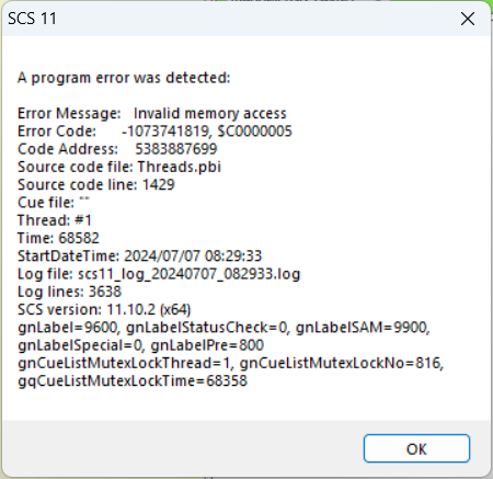

Re: "invalid memory access" error when creating a new lighting cue in editor after preparing fixtures
it doesnt metter what version i use. the old logfile is already overwritten and i missed to store it... so i updated to the newer version, you can see in the log file. but it doesnt seem to be the problem of the scs version as im getting the same error with the new version.
i can reproduce the error today with the new scs version and send you the sceenshot and the logfile of the same error again
- Posts: 4
- Joined: Sat Jul 06, 2024 7:06 am
so here is a screenshot and a logfile of the same error happening just right now. both belong together this time .
thank you for help
thank you for help
- scs error today.png (91.52 KiB) Viewed 9755 times
- scs11_log_20240707_082933.zip
- (61.36 KiB) Downloaded 305 times
Hi Max, we have apossible solution for you to test, can you please send an email to support@showcuesystems.com and I will provide you with a link to a beta version for you to try.
- Posts: 4
Awesome ! The Version you´ve send me works. No Memory error anymore .
Thank you for that awesome support.
cheers Max
