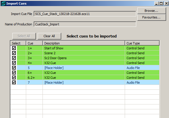

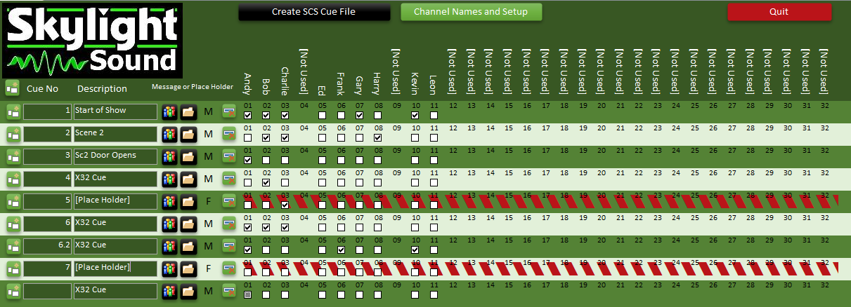

The only negative was the amount of time to program SCS. As I plan to use this for most shows, I decided to write a program to give a graphical way to view and update each of the Control Send Cues. It is created as a database which then writes it's own SCS11 file in the correct XML format. This file can then be imported via the "Import Cues from another SCS Cue file" within the Cue menu of the editor window. It also deals with the limit of 16 Control Send messages per cue, by automatically creating Sub Cues. In fact you can decide how many of the channels you want in each Sub Cue. That's quite handy because you have to scroll down the list of control messages within the sub cue which only currently shows around 9 messages by default in SCS.
Once you've got the majority of Control Send cues into SCS you can then play around with SFX cues (I've allowed [Place Holders] just for audio for now) or other requirements directly in SCS.
I wonder if anyone else is interested in the concept and might benefit from this system? I've only quickly written this in MSAccess but might look to write in VB.net if there is any interest? I'm happy for anyone to have it in the MSAccess version at the moment. You can grab a runtime version of the software free from Microsoft and I can upload the file to dropbox or similar.
I've still got some code tidying to do and might add in more functionality (although you can duplicate cues at the moment and it does check for duplicate cue numbers etc...)
I've attached a couple of screen shots just to give a flavour of the system - It's working great and I'm about to give it a run next week.

- Importing into SCS

- Creating a cue sheet

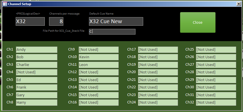

- Setting up the channels

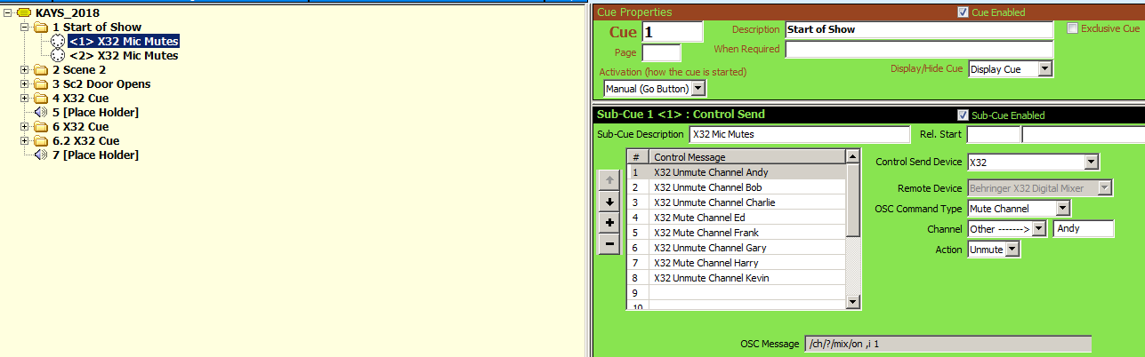

....... and the Control Sends showing correctly in SCS.
- Cues in SCS
- 4.png (43.61 KiB) Viewed 11240 times

A friend of mine asked if I can only get it to message changes rather than sending each channel. For example if you had 12 channels in use and only wanted 1,2 3 Unmuted and 6,8 Muted off that it only send 5 messages rather than the 12.
So I have quickly altered the system to be able to do both. Basically using the triple state of the check box. Tick is Unmute, blank is mute and shaded is ignore (no change).
He also mentioned that he uses the cue description box to note the changes of the channel numbers. I am going to get the program to (optionally) automatically populate the description box, so in the case above the description would say "Unmute: 01 02 03 / Mute: 06 08" - I could do the names but the text would be long (again I will put that as an option).

Also you can auto populate the description with the actual channel name rather than just the channel number. Might be of use.
