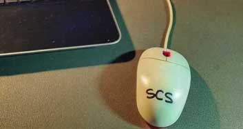

I use a modified old mouse as cue trigger device for the show operator.
It is an old usb optical mouse where I disassembled the wheel and connected both buttons to the right one. The bottom scanner is blinded with black adhesive tape.
Its internal light makes it visible in a dark environment.
A "Very High Tech" device.
