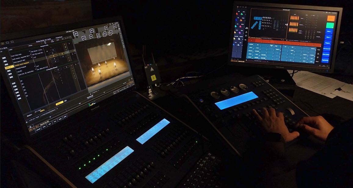

Re: OSC to ETC lighting desk
We used this:
/eos/cue/1/1/fire
With this ETC Desk:
/eos/cue/1/1/fire
With this ETC Desk:
