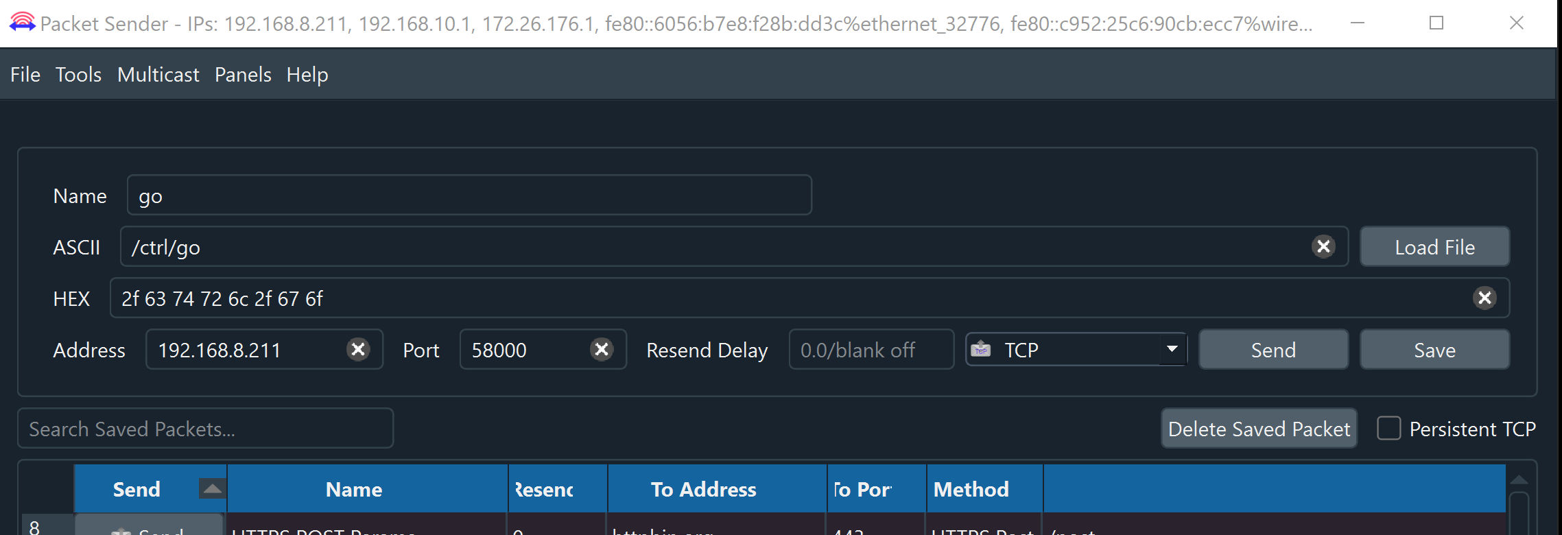

You cannot use http to send osc requests. use "Packet sender" a free tool, or you could use "TouchOSC"
See attached screenshot for Packetsender example.
https://packetsender.com/
https://hexler.net/touchosc
- packet_sender.jpg (201.2 KiB) Viewed 8596 times
