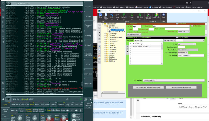

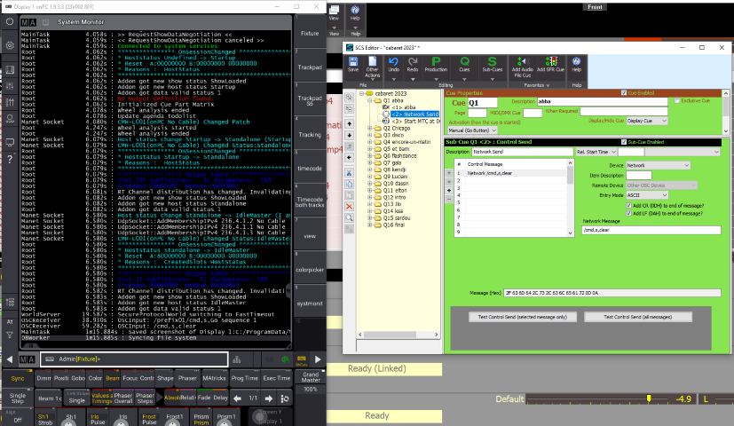

Hello every one,
I want to create a link between the software windows show cue system and grandma3 onpc.
Show cue system SCS has to send OSC message to activate plugin on grandma3
Connection works, system monitor received the message but i think it is bad formatted and grandma3 doesn't acrtivate it.
this is the screenshot. I tried o lot of cases.
do you have an idea?
thank you

Something's not right about the Control Send display. For 'Other OSC Device' the 'Entry Mode' and following fields should not be displayed, but instead you should see 'OSC Command Type' and 'OSC Message'. Please email me the SCS log file from a run in which this happened. Log files are created and saved in a folder named "SCS Logs" under "Documents", and the name of each file includes a time-stamp indicating when the log started.

I sent my logs, but, I understand what you wrote,
I deleted the line on my cue, then the menu will be reseted so now it works !
I think I tried to change control send settings after doing the cue, so it stayed the menu of another osc mode.
