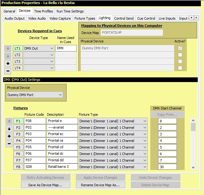

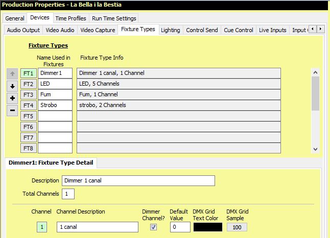

I create fixture types to define channels for the fixture.
Then I create a theatre distribution with lights with names and fixture types and I set the dmx channel.
lighting map.JPG (94.07 KiB) Viewed 3423 times

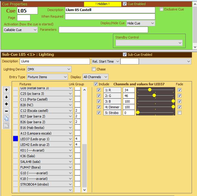

The light cues have a list of lights by name with its setups.
light cue.JPG (87.9 KiB) Viewed 3423 times
Then I only need to change the dmx channel of each fixture in the device map.
If the fixtures of one theatre have diferent number of channels may be little bit difficult to re-assign the right dmx channel to the right fixture.
