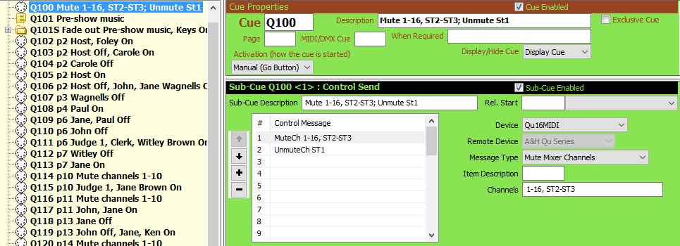

Are you frequently having to turn actors' mics on and off during a play? I'm preparing for a new play and have modified SCS to simplify this process when using my A&H Qu-series mixer - see screenshot. I can now mute or unmute multiple channels in a simple user-friendly Control Send command, instead of having to work out the detailed MIDI control messages. I'm planning to extend this to also support A&H SQ-series and possibly other mixers. If this is of interest to you, please let me know, and what make and model of digital mixer you are using.
- SCSMixerExample.png (55.29 KiB) Viewed 86458 times

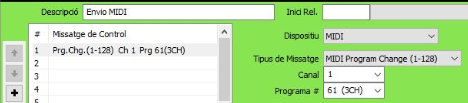

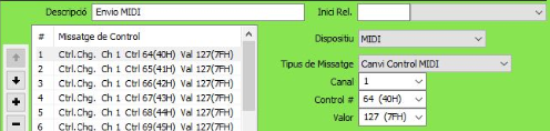

This feature looks very interesting.
We use an old yamaha 01v96 and use midi control send to mute and unmute mics and activate scenes.
I have a cue with all mute and unmute midi controls that I paste each time I need it.
If it's possible to add yamaha 01v96 I will be very grateful!!!
The controls for mute/unmute are: From control number 64 to 87 (24 channels, we use adat module attached)
Value 0 for mute and 127 for unmute
Also we use scene change: Where program number is scene number from 1 to 99 and 00 for 100
