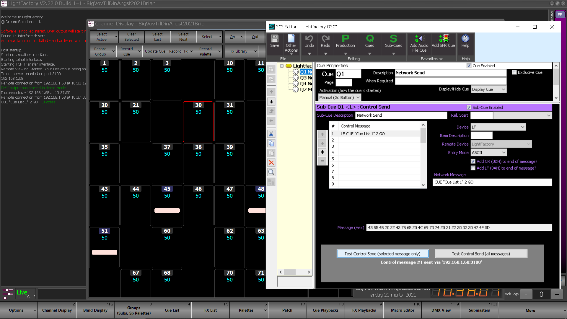

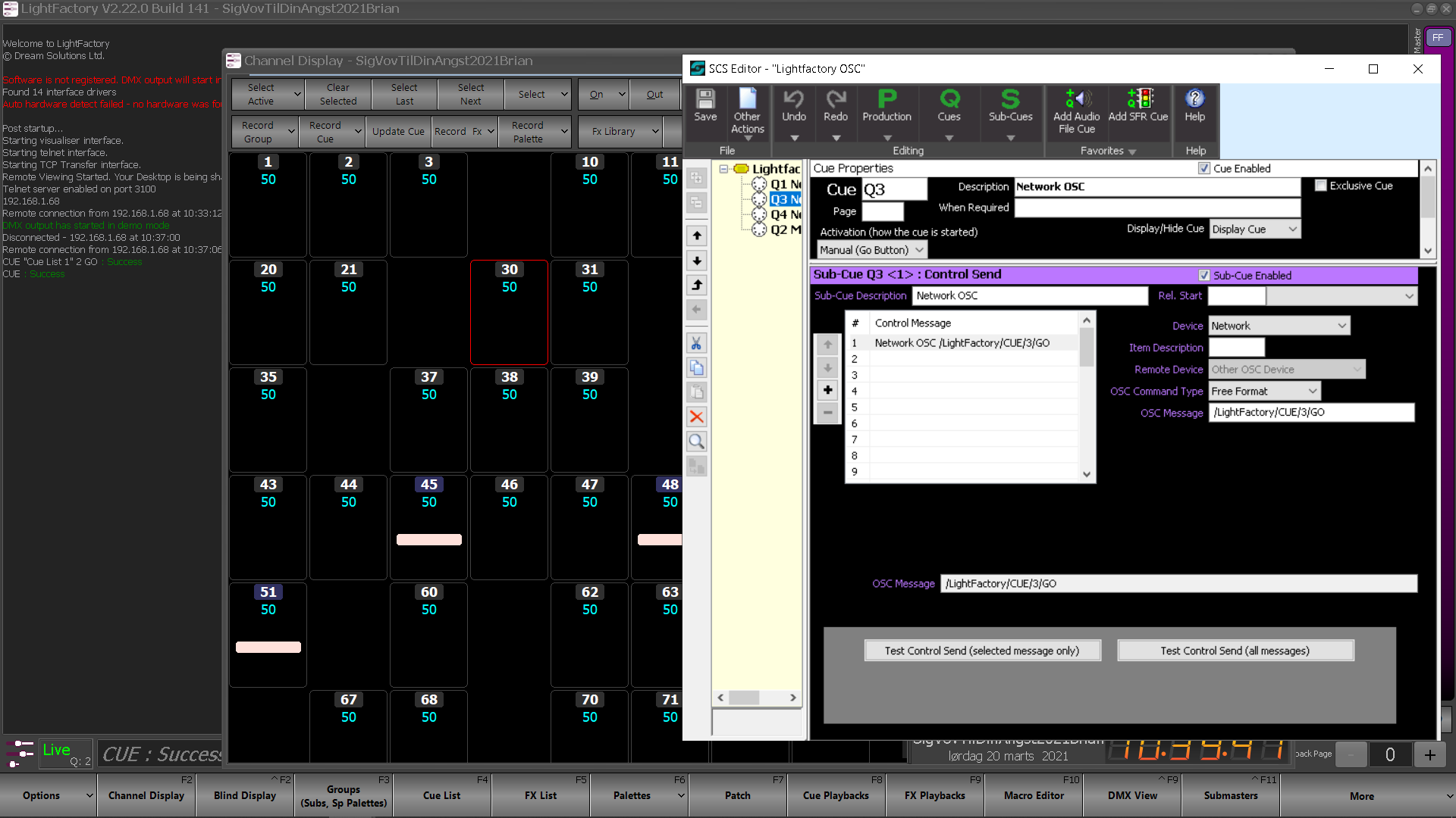

Well.... I already tried that type of message /LightFactory/CUE/3.4/GO, but nothing happens. LightFactory only says CUE: SUCCES. Look at these examples:
Through Telnet port 3100 - Works
Telnet Remote.png (168.49 KiB) Viewed 3571 times
Through UDP OSC free format port 9000 CUE GO - Not working
OSC Free format CUE GO.png (162.03 KiB) Viewed 3571 times

Post by Mike Daniell » Mon Mar 22, 2021 12:02 pm
There is an issue in the handling of OSC Free Format messages where there are no OSC arguments. To avoid this issue, set the Control Send device's 'Remote Device' to 'LightFactory', as you have done for the example shown in your first screenshot. Note that you can change the Network Protocol to UDP if you wish.
