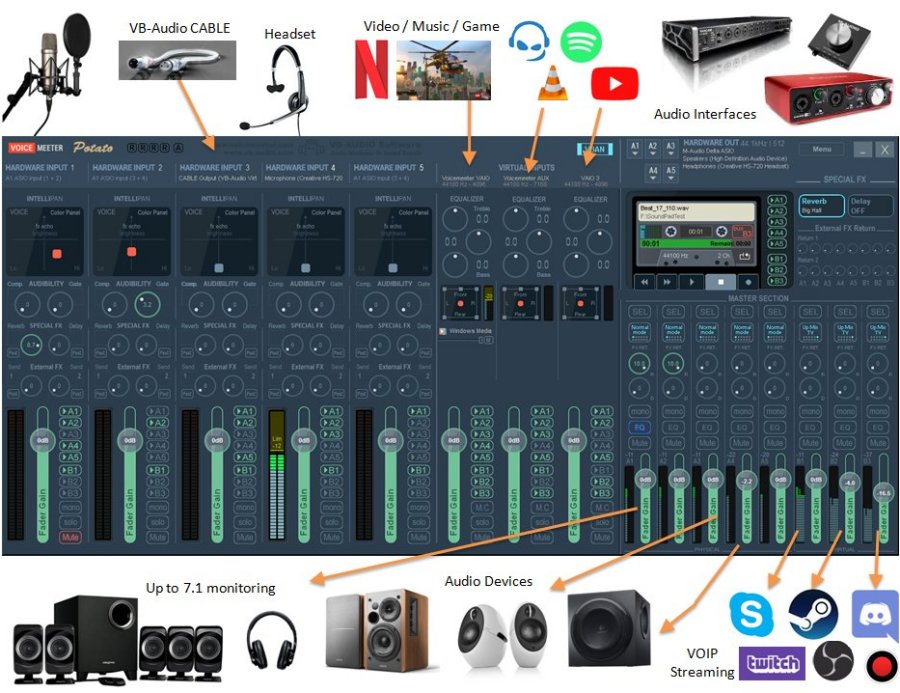

I use Voicemeter Potato mixer which is a donationware. Then you can route what you hear on your computer directly into your favorite DAW. I use Reaper or Cubase. You can also record within the Potato mixer and other cool features.
https://www.vb-audio.com/Voicemeeter/potato.htm
