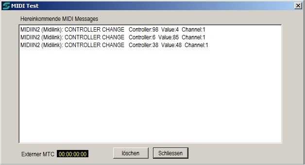

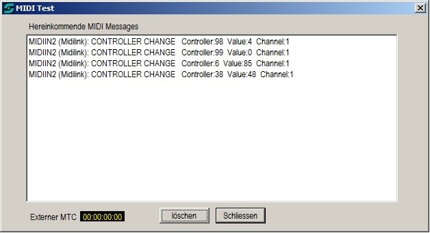

I just opened the MIDI-Test-Window for the first time since I updated from 11.7.1.3 to 11.8.3.2 and to my surprise only three of the four MIDI CC Messages forming one NRPN were displayed:
Luckily I kept 11.7.1.3 installed (just in case I'd have to do a rollback), so I could take a screenshot of what 11.7.1.3 shows when the same NRPN (Fader Ch5 -7dB) arrives from the QL. This is where I got all the values for my NRPNs from since I've started programming them.
So with 11.8.3.2 I won't be able to create new NRPNs because the MIDI CC for #99 doesn't show anymore ...

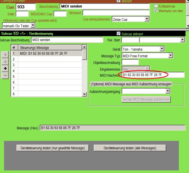

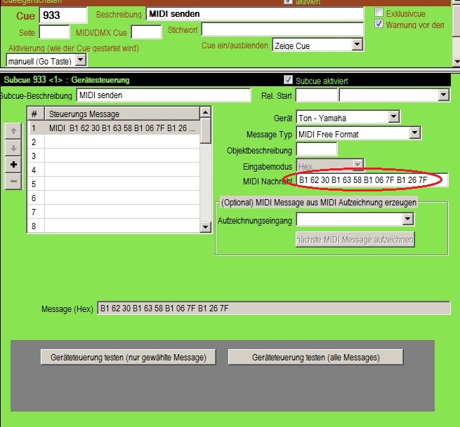

I just did a test to verify my presumption: When sending an NRPN to the QL only the first MIDI CC Message needs the STATUS Byte (Bn).
As an example: The two following NRPNs have exactly the same result (Ch1>Mix1 ON) when being sent to the QL:
NRPN with all STATUS Bytes.jpg (108.78 KiB) Viewed 114622 times
NRPN only with LSB STATUS Byte.jpg (108.84 KiB) Viewed 114622 times

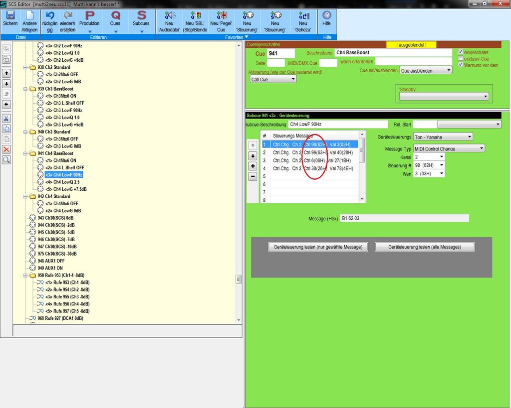

I just saw that promising NRPN-Capture function that would have made programming NRPNs at least ten times faster because until now creating a single NRPN for the QL means for me to navigate to 'Production Properties' > 'Cue Control Devices' > select the respective device and open the MIDI-Test window > send the NRPN from the QL > take a screenshot > open Windows Paint and insert the screenshot > navigate back down the tree of the Cuelist > create a MIDI CC Cue and enter four messages with the numbers of the screenshot. Although I've gotten pretty fast in doing this routine it still slows down my programming speed noticeably.
I don't know if this would be easier to implement, but it would work fine for me if a 'MIDI Free Format' Cue would allow me not only to capture the next MIDI Message but the following [n] MIDI Messages (n=4 for NRPNs). Of course I still would have to change the STATUS byte of the captured messages to the correct value but that's a matter of seconds.
